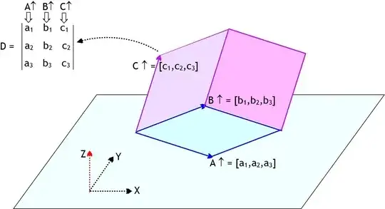

I want to use a geometric approach: intuitive, informal and not so techie.
The determinant, usually algebraically defined, will be defined here as Gram Zeppi said, as representing an n-dimensional volume, from the abstraction of seeing the columns as n-dimensional vectors, forming the edges of a hyper parallelepiped expressed by determinant.
Volume and Determinant
In this case there are basic properties, which serve as a starting point to deduce the Laplace Expansion, usually taught in the definition of Determinants in schools and universities.
1) The volume of a transposed matrix (when one changes rows to columns) is ​​equal to the original matrix volume. In fact, it is expected by symmetry. Thus, the properties valid for columns, described below, are also valid for rows.
2) The vectors in the columns must be independent linearly, so that the volume is different from $0$. For example, In $2D$, two collinear vectors (multiples) don’t form a parallelogram. In the $3D$ case, three coplanar vectors (the situation that happens when one vector can be obtained by the linear combination of the other 2) or 2 collinear vectors generates a null volume.

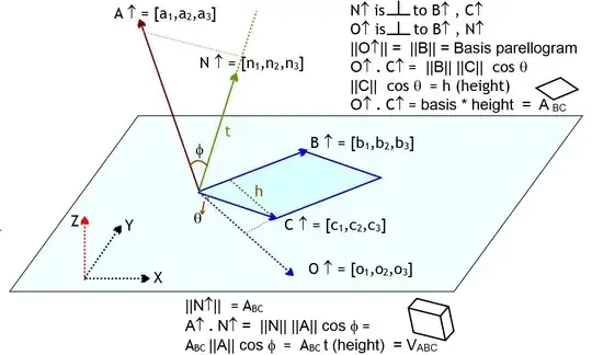

If the vector $\mathbf {\vec{b}}$ and $\mathbf {\vec{c}}$ are independent linearly, they are contained in a plane inside 3D space. Now we will find the area spanned by $\mathbf {\vec{b}}$ and $\mathbf {\vec{c}}$. It wouldn’t be necessary, because we could use 2D space using vector module, but it’s interesting to see how it’s possible to avoid cross product usage at all.
First, we will find a normal $\mathbf {\vec{n} = [n_1,n_2,n_3]} $that is perpendicular to $\mathbf {\vec{b}}$ and $\mathbf {\vec{c}}$ simultaneously. So $\mathbf {\vec{n} \bullet \vec{b} = 0}$ and $\mathbf {\vec{n} \bullet \vec{c}= 0}$.
Therefore
$\mathbf {b_1 n_1 + b_2 n_2 + b_3 n_3 = 0\quad}$ and$ \mathbf {\quad c_1 n_1 + c_2 n_2 + c_3 n_3 = 0} $
As it only matters the normal direction, one can consider $\mathbf {n_1 = 1}$ and solve the above equations.
Now, we need find an orthogonal $\mathbf {\vec{o}}$ coplanar to $\mathbf {\vec{b}}$ (could be $\mathbf {\vec{c}}$ , whatever) and orthogonal to $\mathbf {\vec{n}} $
To find $\mathbf {\vec{o}}$, we use the same kind of equations above with $\mathbf {\vec{n}}$ and $\mathbf {\vec{b}}$ coefficients. After we find $\mathbf {\vec{o}}$, we normalize to $\mathbf {\|b\|}$ magnitude. So
$ \mathbf {Area_{bc} = \vec{o} \bullet \vec{c}}$
Why? Because dot product projects $\mathbf {\vec{c}}$ in $\mathbf {\vec{o}}$ (normal to $\mathbf {\vec{b}}$) multiplying by $\mathbf {cos \theta}$, the angle between $\mathbf {o}$ and $\mathbf {c}$, resulting in the parallelogram height that will be multiplied by $\mathbf {\|\vec{o}\|}$, that is $\mathbf {\vec{b}}$ basis.
To get the volume (our initial goal) the normal $\mathbf {\vec{n}}$, has to be normalized with magnitude equal to area spanned by $\mathbf {\vec{b}}$ and $\mathbf {\vec{c}}$ producing $\mathbf {\vec{n_{bc}}}$, so
$ \mathbf {Volume =\vec{n_{bc}} \bullet \vec{a}}$
For what reason? if $\mathbf {\vec{a}}$ in column $1$ was a vector with magnitude $1$ normal to plane that contains $\mathbf {\vec{b}}$ and $\mathbf \vec{c}}$ , the volume generated would be equal (in value) to $\mathbf {Area{_bc}}$ in plane. It’s a $3D$ solid with height $1$ at right angle so the volume is the basis area $\times $height.
Generally the vector $\mathbf {\vec{a}}$ is oblique to the basis $\mathbf {\vec{b} \vec{c}}$, so if the angle between $\mathbf {\vec{a}}$ and basis $\mathbf {\vec{b} \vec{c}}$ is $\mathbf{\phi}$, the volume is $\mathbf {Area_{bc} \, * \|\vec{a}\|cos\phi}$

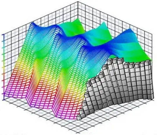

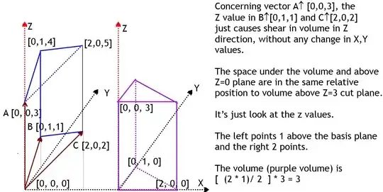

**c) **Any N-dimensional shape represented by a matrix can be broken down into an amount $\mathbf {s}$ of small cube matrices $\mathbf {B_k}$ ($\mathbf {k}$ is an index from 1 to s) of dimension $\mathbf {\beta}$ (diagonal matrix with only $\mathbf {\beta}$value), where $\mathbf {\beta}$ is arbitrarily small and therefore $\mathbf {s}$ arbitrarily large.
Look at the volume below the colorful surface, above the plane $\mathbf {z=0}$ (vertical axis), below the plane $\mathbf {y=0}$ (negative y) to down and left, right to the place $\mathbf {x=0}$ (positive x). Imagine put inside this volume thousands and thousands ($\mathbf {s}$) of tiny cubes.
product of matrices vs determinants
$\mathbf {Det(B) = Det(B_1) + ... + Det(B_s)}$ $\mathbf { Det (A) * Det (B) = Det (A) * (Det (B_1) + ... + Det (B_s)) = s Det (A) \beta^N \qquad}$ (c1) $\mathbf { Det (A * B) = Det (A * (B1 + ... + B_s)) = Det (A * B_1) + ... + Det (A * B_s)} $
By (b) above
$\mathbf {= \beta^N Det(A) + ... + \beta^N Det(A)\qquad}$ ($s$ times) $\mathbf {= s Det (A) \beta^N \qquad}$(c2)
So by (c1) and (c2)
$ \mathbf {Det (A * B) = Det (A) * Det (B)}$
