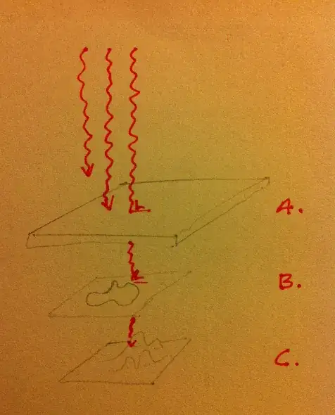

In the illustration above, $A$ is the glass sheet, $B$ is the acetate print out, and $C$ is the chemical-coated, three-dimensional object. I suspect that what I'm asking for will be quite difficult, but I have a CAD file of the object--it looks nothing like that in the illustration. Of course, $A$, $B$ and $C$ will all be put as close together in the eventual run of the project. I'm wondering if perhaps this question is more optical/physics-related than mathematical. I mean, if light is coming through the glass, what is the trajectory after that on to the surface? I'm wondering how flaring might effect the projection due to the distance between the glass and the object--provided it's not a flat surface.
