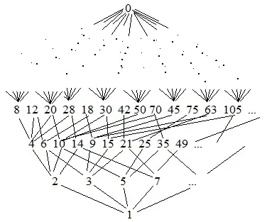

The next best candidates are those things just above $1$. What just above means becomes clearer if you draw a picture:
divisibility diagram
This is a sort of Hasse diagram for the nonnegative integers partially ordered by divisibility. Since the diagram is infinite it's not really a Hasse diagram, and the lines to zero don't really come from any numbers, but this is good for our purposes.
From the diagram you can easily see that the primes lie in the first row above $1$, and so they are "as small as possible" without being $1$, and moreover, everything above them (excepting zero) is built out of various combinations of the primes. The gradeschool definition of prime number basically amounts to the fact that nothing lies between $1$ and $p$ for each prime.
Zero, paradoxically, is really aloof and nowhere near the rest of the primes: he doesn't seem very small after all. Moreover he is pretty useless for building numbers since $0n=0$ for any $n$.
So for reasons like these, $0$ is not considered as a prime: he doesn't make a good "atom."

    So if we were talking about ideals instead of numbers in $\mathbb{Z}$, then we would agree that the zero ideal is a prime ideal, right? Why is the picture so different for ideals? – ziggurism Apr 04 '20 at 15:25
  • @ziggurism It’s because the notions of “prime” and “irreducible” elements are slurred together in PIDs. The context of the question is “prime numbers”, which is focused more on irreducibility, and not ideals. So yes, it isn’t consistent with the zero ideal being allowed to be prime, but it is consistent with 0 never being irreducible. – rschwieb Apr 04 '20 at 16:51
  • At no point am I arguing that there are no statements that make sense with a definition of “prime element” that allows zero, in just highlighting the reasons why we prefer this way when teaching prime numbers for the first time. – rschwieb Apr 04 '20 at 16:52
    Ok so this is really the answer for "why is zero not irreducible", but we allow ourselves to conflate irreducibility and primality in $\mathbb{Z}$. But to be clear, the Hasse diagram of ideals of $\mathbb{Z}$ ordered by reverse inclusion looks the same as the above divisibility diagram, right? – ziggurism Apr 04 '20 at 16:58
  • @ziggurism yes, it is the opposite diagram of containment, since “contains means divides” in PIDs – rschwieb Apr 04 '20 at 19:03
  • Maybe this diagram tells why the zero ideal is the generic point – ziggurism Apr 04 '20 at 19:11
  • This answer makes it clear that while not being prime, 1 is also not composite either. But what about 0? Is it composite? – ziggurism Oct 03 '20 at 14:00
    @ziggurism I’d say 0 and 1 don’t really belong in this graph, although they “fit” this way. All of the interesting things about factorization happen strictly between them. Remember, technically I can’t even write anything on the other end of those lines from 0. While $0$ is divisible by more than one prime, I wouldn’t call it composite: that’s more of a statement about a unique factorization, which 0 does not have. – rschwieb Oct 03 '20 at 16:49
