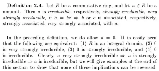

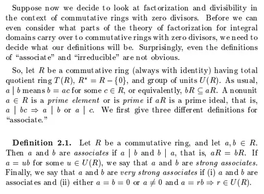

It's worth emphasis that is not the definition of irreducible that is used by many ring theorists studying factorization theory and related matters in general commutative rings. As described in the paper excerpted below, common (integral) domain notions like "associate" and "irreducible" bifurcate into a few inequivalent notions in the presence of zero-divisors. Motivated by extending results on unique factorization to non-domains, this gives more insight for the most useful notion of irreducible and associate, including whether or not $0$ should be considered irreducible. It turns out that using such definitions yields that $0$ is irreducible iff the ring is a domain (for all notions of associate and irreducible). In particular this means that $p$ prime $\Rightarrow$ $p$ irreducible is true for all $p$ (including $p = 0)$. Below are the definitions in use.
Excerpted from: Factorization in Commutative Rings with Zero-divisors.
D.D. Anderson, Silvia Valdes-Leon.
Rocky Mountain J. Math. Volume 28, Number 2 (1996), 439-480
Bill Dubuque
