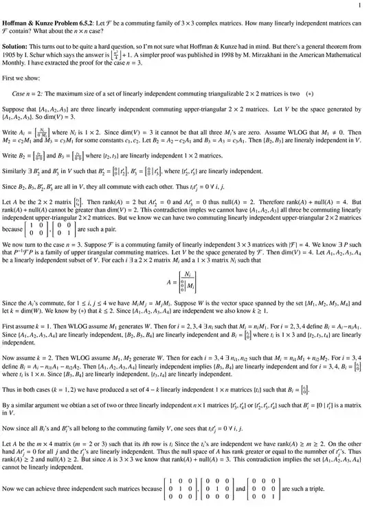

I followed the link posted by Prahlad Vaidyanathan that gives a general (simplified) proof of Shcur's theorem which gives the exact answer for any $n$.
Based on that proof I don't know what Hoffman and Kunze could have possibly had in mind for the general case because it's non-trivial. The case $n=3$ may have a simpler proof that Hoffman and Kunze did have in mind but I have not been able to come up with anything simpler than extracting that proof as a special case of the simplified proof of Schur's theorem.
I typed up the proof in the case $n=3$ (which incidentally required proving it also for $n=2$). The LaTeX involved was sufficiently complicated that I've been unable to translate it into MathJax. So I'm displaying it as an image.
I would not have bothered doing this except that Hoffman and Kunze is such a timeless classic that it seems there should be better solutions available online. This at least fills one hole.
You can click on the following to make it bigger. Click once to bring it up in its own window and you might need to click again to enlarge it. But it is high res you should be able to read it.
Hoffman and Kunze Exercise 6.5.2

From what I can gather, this seems like a hard problem to pin down an exact bound for, however I suspect the book just wants you to notice that all these matrices will be simultaneously triangulable. Linear independence does not change when conjugating by an invertible matrix (this is what I alluded to in my comment above), so the dimension of this space is $\leq$ the dimension of all upper triangular matrices; which is ...
[Also see large sets of commuting linearly independent matrices, and the link therein to a theorem of Schur.
Very interesting indeed]
