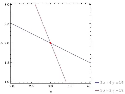

When you have a system of equations, let's say, lines. If you graph them, you'll see that the lines intercept at a common point. This point is the solution of the system. So, when you create another equation based on the equations of your original system, like, adding one to another, you're creating a totally new line, but the solution will be the same.
Think about this system:
$$2x + 4y = 14$$ $$5x + 2y = 19$$
This can be viwed as a matrix (The system can be viewed as something like this 'matrix')
It has a solution $S\{x=3, y=2\}$
Now, let's say you get the second line and replace it by the second line minus the first line, so, you know that the second line is $$5x + 2y = 19$$

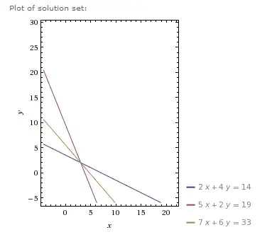

Now by adding the equal therms we have a third equation to our system:
$$7x + 6y = 33$$
You see? You added one equation to another! :)
That also share the solution $S\{x=3, y=2\}$. Of course, this will be a new line, but in the system of equations you only care about the solutions to the system. It doesn't matters if it will be a different line. You've just found another line that intercepts your system at the solution.

So you had this system of lines:
Then you created a new system with the third equation:
But all them has the same solution
