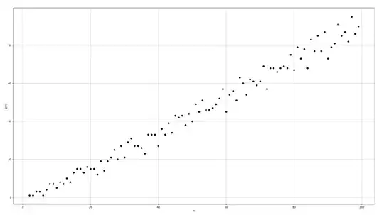

Also, setting $G_n$ to be the set of gaps $n-v_2(d+1) , \forall d\mid 3^n-2^n $ and $g(n)=\min(G_n)$
we remark that $g(n) > 0$ and $g(n)=\mathcal{O}(n)$
g(n) in function of n
So, as $n$ grows up $v_2(d+1)$ became much smaller than $n$ which is assured by our conjecture !
from sympy import divisors
def val_2(n): return (n & -n).bit_length() - 1
plt.grid(True) plt.xlabel("n") plt.ylabel("g(n)") for n in range(2,pow(10,2)): G=[] for d in divisors(pow(3,n)-pow(2,n)): G.append(n-val_2(d+1)) plt.scatter(n,min(G),c='black')
plt.show()
