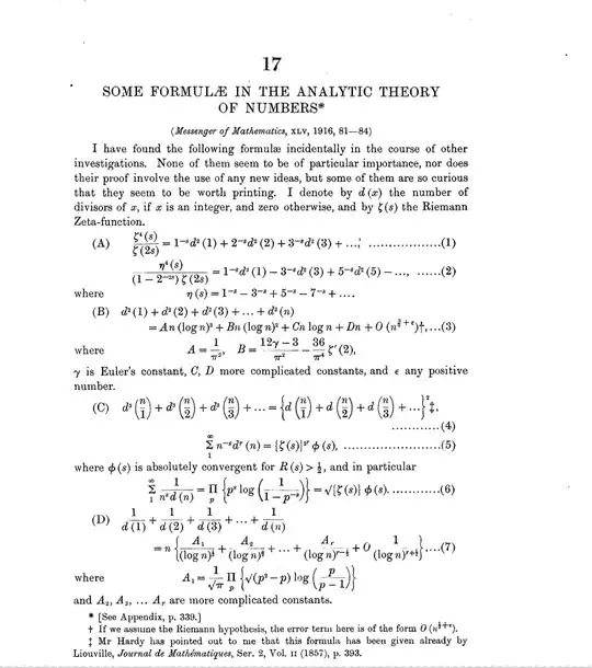

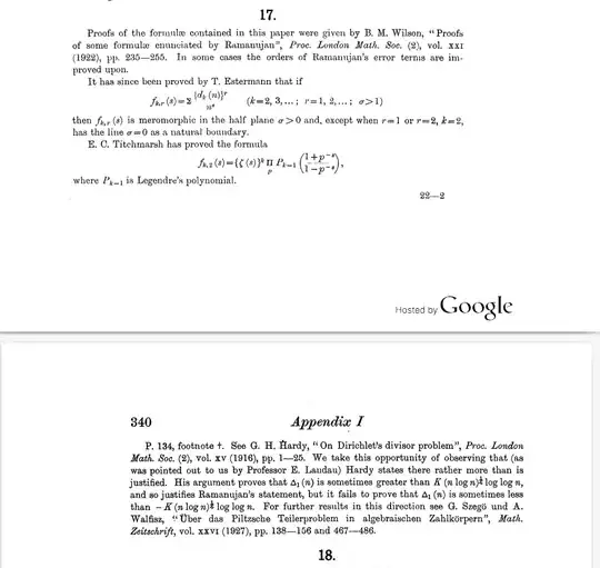

    in the notes at the end of the chapter, they refer to Ramanujan Collected Papers pages 133-135, which is a brief article from 1916. They mention B. M. Wilson (1922) in the Proceedings but no title. – Will Jagy May 16 '25 at 17:03

the original, and the correct title for the Wilson reference, which gives proofs. See also https://en.wikipedia.org/wiki/Bertram_Martin_Wilson

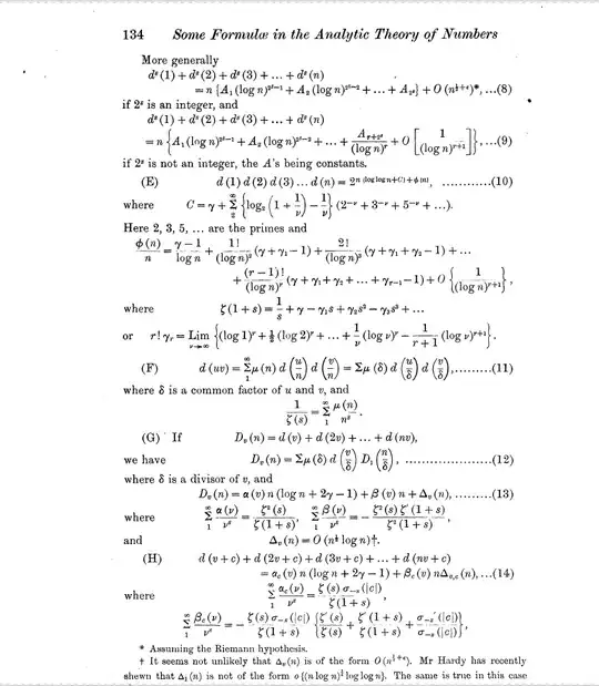

  • If g is an integer, is the left hand side of equation (9) asymptotically equal to the first term on the right hand side (that is the ratio converges to 1)? The $A_1$ in equation (9) is not the same as the $A_1$ defined after equation (7) and I assume it depends on g, right? Is there an explicit formula for $A_1$? – John L May 28 '25 at 14:05
