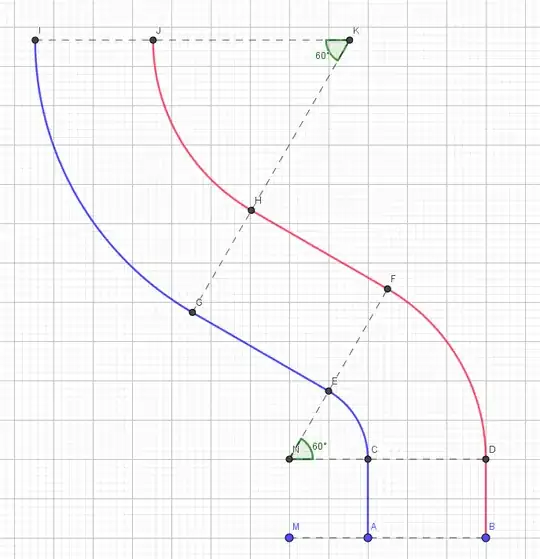

Consider the left wheel and the right wheel of a car (say, rear wheels). The distances two wheels travel differ when they turn left or right. But, if the car starts traveling towards the north direction and ends traveling towards the same direction, and if the car doesn't rotate fully, then I suspect that the two distances are always the same.
wheels
Look at the picture. I'll use the angle (change of the orientation angle) instead of the curvature or the radius of curvature. The car (1) goes straight (angle = 0), (2) turns left (angle = $\pi/3$), (3) goes straight (angle = 0), (4) turns right (angle = $-\pi/3$). The two wheels travel the same distance at (1) and (3). The right one travels more in (2) and the left one travels more in (4). But in (2) or (4), the difference between two circular arcs depends only on the angle and the distance between the wheels, which is a constant. So (2) and (4) cancel out and two wheels travel exactly the same distance. That is,
$$\Delta d = d_1-d_2=r_1\theta-r_2\theta=(r_1-r_2)\theta$$
depends only on $r_1-r_2$ and $\theta$.
So the answer is yes in the trivial case shown in the image. But it's just the case when the curvature is (piecewisely) constant-valued and discontinuous, which is quite unnatural. In fact, the car moves smoothly and the curvature changes continuously and I cannot think of the blue and red curves as combinations of circular arcs and line segments.
How can I verify that it is still affirmative in the general case?

    For a conventional car with front wheel steering, those are not tracks the front wheels would follow. The rear wheels might follow tracks like that. – David K Mar 15 '25 at 23:27
    What makes you think the path consists only of line segments and circular arcs? – Ted Shifrin Mar 16 '25 at 00:01
  • @DavidK Thanks, I'll consider rear ones instead. I edited. – govindah Mar 16 '25 at 00:22
  • @TedShifrin Since it is easy to start with. I can compute the whole things with elementary math. But the things in reality is more complicated. I'm asking how this can be described, computed, proved or disproved using calculus or possibly differential geometry. – govindah Mar 16 '25 at 00:24

This is a nice question. Assuming the car makes no full rotation, you are correct in your assertion when the path is gently curved.
Let $\alpha(s)$ be the position of the center of the axle (assuming it's the rear axle and can't turn). Then $\alpha'(s)$ is orthogonal to the axle, and we can assume $\|\alpha'(s)\|=1$. Let $\alpha'(s)=T(s)$ and say $T(s),N(s)$ forms a positive-oriented orthonormal basis for each $s$. We have the equation $T'(s)=\kappa(s)N(s)$, where here $\kappa$ has a sign. The two wheels are at positions $\beta_\pm = \alpha \pm \lambda N$, where $2\lambda$ is the length of the axle. The basic curvature equations are $T'=\kappa N$, $N'=-\kappa T$, and so $$\beta_\pm' = \alpha'\pm\lambda N' = T\mp\lambda\kappa T = (1\mp\lambda\kappa)T.$$ The distances the wheels travel are given by$^*$ $$\int\|\beta_{\pm}'(s)\|ds = \int ds \mp \lambda \int\kappa\, ds.$$ The first term gives the distance traversed by $\alpha$. It is well-known (see, e.g., section 3 of chapter 1 of my differential geometry text, linked freely in my profile) that $\int \kappa\,ds$ gives the net change of the angle of the axle. Your assumption, then, is that this is $0$ (and no multiples of $2\pi$ are involved). Therefore, both $\beta_+$ and $\beta_-$ traverse the same distance.
$^*$I assumed here that $1\pm\lambda\kappa\ge 0$. However, if one quantity changes sign, then there will be a discrepancy, as one integrand will be $1+\lambda\kappa$ (say, with $\kappa$ large positive) and the other $\lambda\kappa-1$. So the difference of the integrals will amount to twice the distance traveled by the center of the axle on that interval. Of course, physically, this means that one of the wheels stops and reverses direction for a while. Is this allowed? It typically means there’s a cusp in the trajectory of that wheel.
Ted Shifrin
  • 125,228
  • How beautiful. So $N$ is not the usual unit normal vector defined by $N(s)=\frac{T'(s)}{||T'(s)||}$. Instead, $N$ is the leftward direction with respect to $T$ and $\kappa(s)$ is signed. I understand that following your setting, it is the case that $\kappa(s)=||T'(s)||$ if it's turning left, and $\kappa(s)=-||T'(s)||$ if it's turning right. But I have a question that I don't understand: why is $N'=-\kappa T$? Does it follow from $T'=\kappa N$? – govindah Mar 16 '25 at 15:19
    Yes, as usual, differentiate $T\cdot N=0$. – Ted Shifrin Mar 16 '25 at 15:20
  • Oh, it was quite elementary. Since $0=(T\cdot N)' = T'\cdot N + T\cdot N'=\kappa+T\cdot N'$, we have $N'=(N'\cdot N)N + (N'\cdot T)T=-\kappa T$. Thanks. – govindah Mar 16 '25 at 16:07
  • So, provided that $1\pm\lambda\kappa\ge0$ and that the car's final orientation matches its initial orientation (without full rotations), the distance covered by each wheel equals the distance traveled by the center of the axle. Thanks for your answer. – govindah Mar 16 '25 at 16:19
