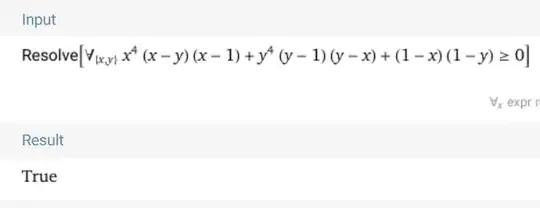

For $t\ge4$, I don't know how to prove. For $t=4$ WolframAlpha verifies it is true: enter image description here
