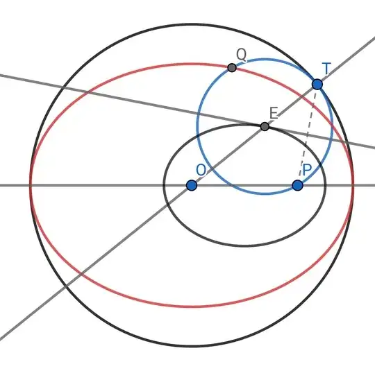

Fix one of the points, say $P$, & examine the collection of “largest circles through $P$”, which will be tangent to the unit circle. I claim that the locus of the centres of such circles is an ellipse with foci at $P$ and the origin, & major axis 1.
diagram
This fact follows from the fact that $OT=1$ and $PE=ET$. The line $ET$ passes through the origin as it is perpendicular to the tangent at $T$. The locus of the antipodal points $Q$ is the red ellipse of twice the size. If $OP=r$ then the area of this ellipse is $\pi\sqrt{1-r^2}$.
We have: $\mathbb{P}[r\le OP\le r+dr]=2rdr$, and $Q$ lies inside our ellipse with probability $\sqrt{1-r^2}$, so integrating our final answer is:
$$ \int_0^1 2r \sqrt{1-r^2} dr = \frac{2}{3}.$$

  • I don't understand how this reasoning guarantees that the circle whose diameter consists of the segment $\overline{PQ}$ is contained within the unit disk. It gives the impression that the circle whose diameter is $\overline{PQ}$ must be tangent to the unit disk, and this is not always the case.. – JUAN PABLO CARDONA BUITRAGO Jan 14 '25 at 16:02
    Fixing $P$, if $Q$ lies inside the red ellipse, then the circle with diameter $PQ$ is inside the disk — it is tangent iff $Q$ is on the ellipse. – tkw Jan 14 '25 at 20:26
