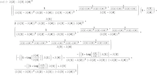

Addition
To answer the comment: Find the mean when the first $k$ $\lambda$'s are not equal but the last $n-k$ $\lambda$'s are all equal to $\mu_{k+1}$ which doesn't equal any of the first $k$ $\lambda$'s.
I have no desire to perform the needed algebra by hand so I'm using Mathematica as in my other answer.
(* Set values for n and k *)
n = 6;
k = 3;
(* Obtain mean when no lambdas are equal *)
μ = Product[λ[i], {i, 1, n}]  Sum[(λ[i] - λ[1] (1 + Log[λ[i]/[1]]))/
(Product[If[j == i, 1, λ[j] - λ[i]], {j, 2, n}] λ[1] (λ[1] - λ[i])^2), {i, 2, n}];
(* Take the limit of μ as λ[k+1],...,λ[n] -> m = λ[k+1] *)
μ = (Limit[μ, Table[λ[i] -> m, {i, k + 1, n}]]) /. m -> λ[k + 1]
Mean for n=6 and k=3
As a check set some $\lambda$ values and perform some simulations:
lambdas = {1, 2, 3, 4, 4, 4};
μ /. Table[λ[i] -> lambdas[[i]], {i, 1, k + 1}] // N]
(* 0.341686 *)
SeedRandom[12345] nSims = 10000000; (* Random samples from n exponentials ) data = Transpose[Table[RandomVariate[ExponentialDistribution[lambdas[[i]]], nSims], {i, 1, n}]]; ( Find x[1]/(x[1]+...+x[n] for each simulation ) z = #[[1]]/Total[#] & /@ data; ( Mean of simulated z values ) Mean[z] ( 0.341589 *)
