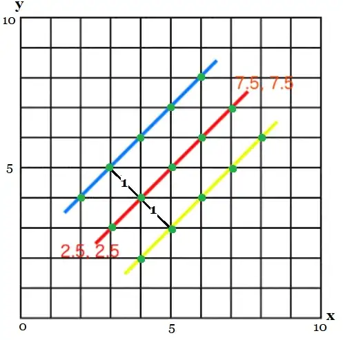

So simply put, I have a line segment defined by two integer points and I move it parallely to two new also integer points. I want to prove that if the line segment before the translation was intersecting with $N$ grid points then it will remain to do so after the translation as described above.
Picture for illustration: green points are intersections with the grid.
line segment moved parallel

I will focus on answering your question as you phrased it in the end, and as demonstrated in your picture, as I am not sure the discussion around rounding is correct/relevant.
Applying a parallel shift to your line means your applying a translation $T$ to all the points on the line. Let $l$ denote your initial line, and $l'$ be the translated line. If $(a, b)\in l$, then $T((a, b)) = (a + \Delta_x, b+\Delta_y)$ for some $\Delta_x$ and $\Delta_y$. In particular, if $T$ takes a lattice point on $l$ to a lattice point on $l'$, then $\Delta_x$ and $\Delta_y$ are integral. Thus, every lattice point on $l$ is mapped to a (unique) lattice point on $l'$. The same holds for the inverse $T^{-1}$ of $T$, so the lattice points on $l$ are in bijection with those on $l'$, i.e., they are equinumerous, as desired.
The above essentially shows that the number of lattice points on a line between two lattice points depends only on the slope of said line. You might be interested in the fact that the number of lattice points on a line segment between lattice points $(a, b)$ and $(c, d)$ is given by $\gcd(c−a,d−b)+1$, see here for a proof.
