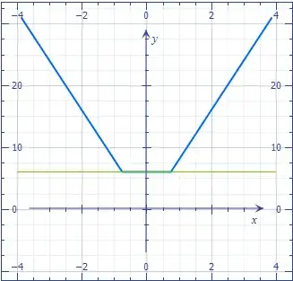

This function is piecewise linear and its graph is a polyline (unbounded). We can solve the problem by looking for crossings between the horizontal $y=6$ and the line segments (or half-lines) that constitute the polyline. The vertices are found where the arguments of the absolute values are zero.
Notice that $4x-3=0$ implies $4x+3=6$ and symmetrically. The vertices are: $$(-\infty,\infty), (-\tfrac34,6), (\tfrac34,6), (\infty,\infty).$$
We conclude that the solution is the whole interval $[-\tfrac34,\tfrac34])$.
