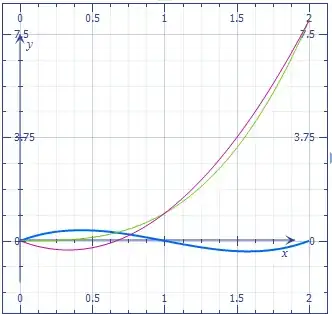

The Simpson's rule was designed by performing quadratic interpolation on three points. So it is naturally exact for quadratic functions.
Exactness for cubics comes as a bonus, because the residue to a cubic when you subtract the quadratic interpolant is an odd function that integrates to $0$.
Green: the cubic. Magenta: the quadratic interpolant. Blue: the error.
This lucky circumstance does not arise with linear interpolation.
