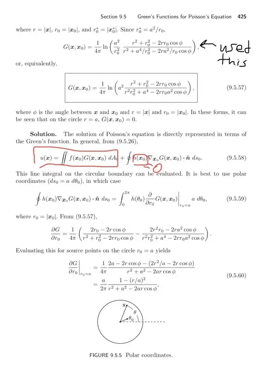

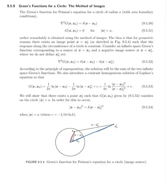

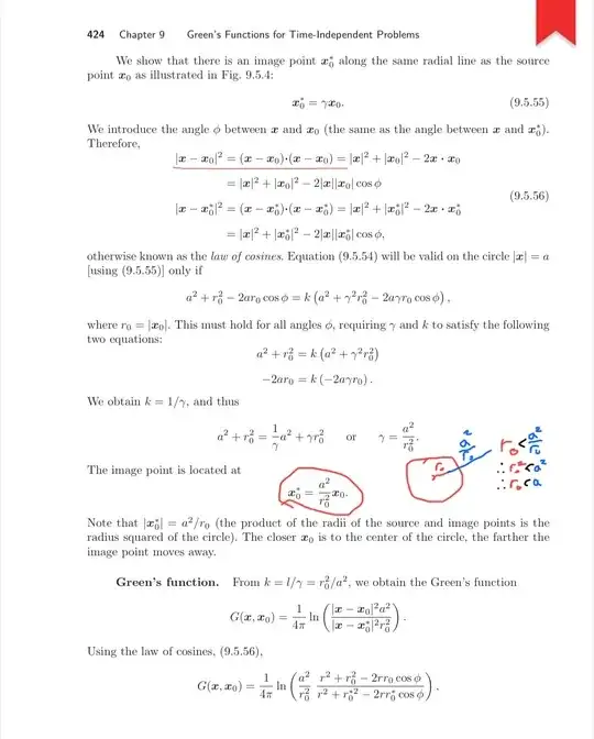

Green's function (which we arrive to using method of images for a circle) for this equation (such that $G(r = a,\theta,r_0,\theta_0) = 0$): $$G(\textbf{r},\textbf{r}_0) = \frac{1}{4\pi}\ln\Bigg(\frac{a^2}{r_0^2}\frac{r^2+r_0^2-2rr_r\cos(\theta-\theta_0)}{r^2+a^2\Big(\frac{a}{r_0}\Big)^2-2r\frac{a^2}{r_0}\cos(\theta-\theta_0)}\Bigg)$$

$$\tag{1} u(r,\theta) = \int_0^{2\pi} \int_0^R f(\textbf{r}_0)G(\textbf{r},\textbf{r}_0)r_0dr_0d\theta_0 - \int_0^{2\pi}u(a,\theta)\frac{\partial G(\textbf{r},\textbf{r}_0)}{\partial r_0}|_{|\textbf{r}| = r= a}d\theta_0 \\ = \frac{1}{4\pi}\int_0^{2\pi} \int_0^R \ln\Bigg(\frac{a^2}{r_0^2}\frac{r^2+r_0^2-2rr_r\cos(\theta-\theta_0)}{r^2+a^2\Big(\frac{a}{r_0}\Big)^2-2r\frac{a^2}{r_0}\cos(\theta-\theta_0)}\Bigg)r_0 dr_0d\theta_0 + 0$$

Images of textbook pages I am reading from:
