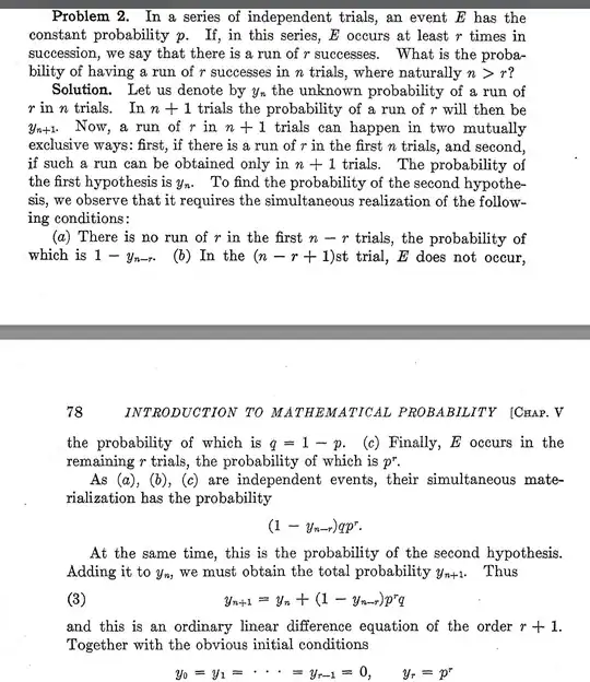

This stack exchange discussion answers the question of the probability of a run of r successes in n trials, given that the probability of a successful trial is p.

My starting point for this is motivated by this explanation in the Upensky textbook referenced in the above stack exchange discussion here:
Following this idea, the first thing we can do is calculate the same conditions: that two runs can achieved in two mutually exclusive ways, that you've achieved both runs at the first opportunity in (r1 + r2 + 1) trials... in this case r1 and r2 are both 5 SSSSSFSSSSSS This is the only permutation of success at the 11th trial, The odds of which are p^5(1-p)p^5. Which would be my starting point using the same "strategy" if you will, as De Moivre.
But what about more than 2 runs of variable length? e.g, given n=200 and p=.3, what is the probability of having at least 3 runs such that r1=7 r2=5 r3=9?
