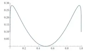

For $n=2$, the difference of the left and right sides in (1) is plotted below for $(p_1,p_2)=(p,1-p)$ (source):
which shows the inequality holds for $n=2$.

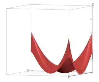

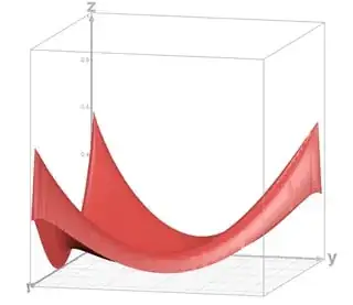

I came across with this inequality in my answer to this question. I guess the above inequality holds for any $n\ge2$ (and any $l_p$ norm) based on my numerical experiments for $n=2$. For $n=3$ it also holds, which can be seen below where the difference of the left and right sides in (1) is shown for $(p_1,p_2,p_3)=(x,y,1-x-y)$ (you can see the 3D version of the plot here, which can be rotated in any direction):
The above inequality indicates that the distance of the probability vector $p\neq\frac{1}{n} e$ from the center of the standard simplex, i.e. $\frac{1}{n} e$ which has the maximum entropy among all distributions on a sample space with $n$ elements, is strictly larger than the distance of the entropy-based probability vector $\frac{-p \log p}{H(p)}$ generated based on the entropies of disjoint events occurring with probabilities $p_1,\dots,p_n$.
