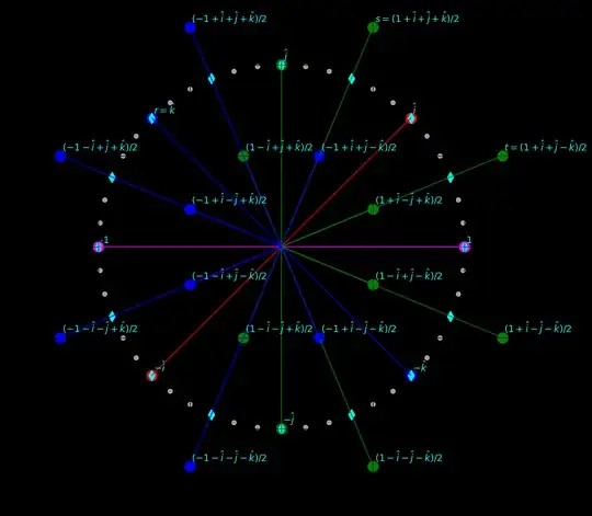

So I made some code to test if I was correctly decoding the projection and made some plots with it in 2D.
Binary_tetrahedral_group
Q4: I made this plot using a $T_o=48$ because it looked like a sufficient enough resolution to encode the 24 elements in the projection into the unit circle as 16 unique angles using an expression of the form $r_n e^{\frac{2\pi i}{48}k}$ for $k=3n$ , being $r_n$ the appropriate modulus for the correspondent element of the projection. I was trying to construct this but realized that might be already done and have a common expression for $r_n \in \mathbb{C} $ that produces a phase shift along with the radius. Maybe this a way to get the Cayley Graph? Is 48 special in this context?

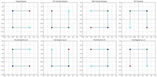

I understand this as the most abstract way to study symmetry. For example thinking on the different ways a square can be rotated with different actions, and recognizing how some combination of actions are equivalent to other simple actions.
"Roughly speaking, a symmetry of an object is a bijection (i.e. one-to-one correspondence) from the object to itself that preserves its structure." https://www.maths.gla.ac.uk/~mwemyss/teaching/3alg1-7.pdf
For example thinking about what are all the "actions" we can take on a square that leave it in an indistinguishable state from the state you started allows you to understand the 8 symmetries in the "Dihedral Group of order 8"
Each action is called a symmetry of the square (in this case we have eight):
binary Decimal Action Expression
000 0 Doing nothing $z \mapsto z e^{2\pi i}=1z$
001 1 Rotation Counterclockwise 90º $z \mapsto z e^{\frac{i\pi}{2}}=iz$
010 2 180º rotation (can be done clockwise or anticlockwise) $z \mapsto z e^{i\pi}=-z$
011 3 Clockwise 90º rotation $z \mapsto z e^{-\frac{i\pi}{2}}=-iz$
100 4 Flipping along horizontal $y=0$ axis $z \mapsto \overline{z}$
101 5 Flipping along diagonal $y=x$ axis $z \mapsto \overline{z}e^{\frac{i\pi}{2}} $
110 6 Flipping along vertical $x=0$ axis $z \mapsto -\overline{z}$
111 7 Flipping along diagonal $y=-x$ axis $z \mapsto -\overline{z}e^{\frac{i\pi}{2}} $
In these expressions, $z$ is a complex number and $\overline{z}$ represents its complex conjugate. This is a way to express these actions with an operation with complex numbers.

Q1: The fact that the generators squared or cubed give -1 (which has order 2) means that their order must be twice these, 4 or 6, to get +1, the unit element.
Q2: The general concept in group theory is to find a minimum set of relations between the group elements that uniquely defines the abstract group. Here we have 3 equations which appear to be a nice/convenient number using 3 generators to let 2T be different (non-isomorphic) to other (the 2 other finite) groups of order 24.
Q3: $r$, $s$ and $t$ are special because they are a set of generators of the group. k is not involved because apparently it is not having any relationship with the group.
Q4: 24 is the order of the group. So obviously any Cayley graph has 24 vertices. (The graph that is shown does not have a vertex in the center of the graph.) The Cayley graph of https://en.wikipedia.org/wiki/Binary_tetrahedral_group#/media/File:Cayley_graph_of_SL(2,3).svg is drawn with 2 generators, one of order 4 (red edges), one of order 6 (black edges). The Caley graph has 24 vertices, each one labelled with one of the 24 elements of the group - either enumerated from 1 to 24 or by one of the 24 quaternions. The Caley graph demonstrats that one can pick 2 generators (two group elements), one of order 4 for the red edges and one of order 6 for the black edges, such that multiplication of a group element at a vertex by the generator leads along the edge to the next vertex. It may need some sort of puzzling for a coherent match; it's not obvious from the outside which of the 6 elements of order 4 and which of the 8 elements of order 6 are consistent with the rest. (Typically there are many differnt pairs of generators that would match the rules and the Caley graph).

  • In Q2 -1 nor k are not regarded as generators. Generally speaking, if a generator g has order o, g^o=1, then the elements represented by g^d, where d|o, have only order d. The generic fact known a priori is that all element orders are orders of the group (see textbooks about groups.) – R. J. Mathar Jul 19 '24 at 14:00
  • I think I get it now, you mean that as $k^8=e^{\frac{3\pi i}{4}8}=1$ is an element and being $g=e^{\frac{\pi i}{2}}$ is the main generator of order 4 . So $g^2=-1$ ,$g^3=-i$,$g^4=1$ . Now the element denoted as r in the projection is $k=e^{\frac{3\pi i}{4}}$ and it's not the generator. – fbatrouni Jul 19 '24 at 14:42
    I added a Calely table to https://en.wikipedia.org/wiki/Binary_tetrahedral_group#Presentation . The convention in that case is that element 1 is the unit element, element 3 is r, element 5 is -1, element 14 is s, and element 18 is t. By doing multiplication within the table (left element the row, right element the column) one can verify that $r^2=s^3=t^3=rst =-1$ . It's not certain that this information will survive (there are too many wikipedians which are deletionists.) – R. J. Mathar Jul 20 '24 at 14:30
