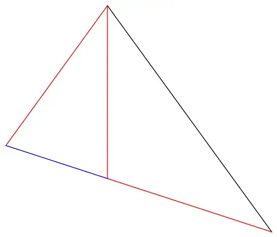

    May be the following: Using "obvioiusly" similar triangles we can easily see that the lengths of the sequence zigzagging line segments $\ell_1,\ell_2,\ldots$, follow the Fibonacci recurrence: $$\ell_{n+2}=\ell_{n+1}+\ell_n?$$ – Jyrki Lahtonen Jul 03 '24 at 05:39

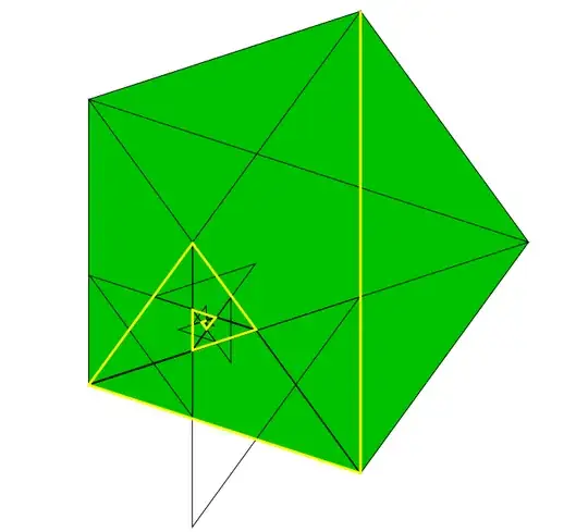

Promoting my comment and image explanation into an answer.
The Fibonacci numbers themselves don't readily appear in a pentagon/pentagram, but the golden ratio and the same recurrence relation do show up. As always, the starting point is the golden triangle — an isosceles triangle with respective angles $2\pi/5$, $2\pi/5$ and $\pi/5$:
We have two similar triangles here leading to the familiar equation. If the length of the blue line is $1$ unit and the length of the red line is $x$, then the big isosceles triangle shows that the black line segment has length $1+x$. But, the similarity of the two triangles yields $x^2$ for that length. Hence $$x^2=1+x,\tag{1}$$ from which we can solve $x=\phi=(1+\sqrt5)/2.$
We can always draw a pentagram inside a regular pentagon by including the diagonals. But, by extending the sides of the same pentagon until they meet, we get another pentagram. Joining its star points gives us a bigger pentagon, and we can keep going like in the following image:
Observe that we could equally well look at the smaller pentagon bordered by the diagonals of a bigger one, draw its diagonals to form a smaller pentagram et cetera.
Anyway, it is easy to calculate the angles that appear in these recursive drawings, and see that they form a sequence of similar triangles. It follows that each pentagon (resp. pentagram) is a scaled up version of the preceding one by a factor of $\phi^2$. We also see that the lengths of consecutive segments forming the red zigzag are sides of isosceles triangles similar to the earlier one. Hence their lengths $\ell_0,\ell_1,\ldots$ all satisfy $\ell_{n+1}/\ell_n=\phi$, and thus satisfy the Fibonacci recurrence: $$\ell_n=\ell_{n-1}+\ell_{n-2}.$$
This is somewhat unsatisfactory because the Fibonacci numbers $F_n$ themselves don't show up — only the recurrence relation. We all know that, by Binet's formula, the numbers $F_n$ need a (small) correction term involving powers of the other root $-1/\phi$ of the equation $(1)$.

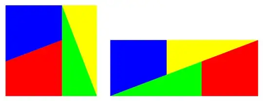

This discrepancy has been a source of recreational mathematics: Missing square puzzle, locally here and here. The idea is explained in the following image
Missing square diagram
On the left we have a square of side length $\phi^2$ subdivided into four polygons in such a way that the vertical as well as the horizontal sides have lengths $1,\phi$ or $\phi^2$. Those polygons can then be perfectly rearranged to form a rectangle of dimensions $\phi\times\phi^3$. All due to the identity $\phi^2=1+\phi$.
The missing square puzzles then emerge when we use consecutive Fibonacci numbers instead of consecutive powers of $\phi$ as lengths. Below see the version with respective side lengths $3,5,8$.
65 vs. 64 missing square
The four polygons in it would, again, form a nice $8\times8$ square, but narrowly fail to fill up a $13\times5$ rectangle. Just as well, given that $13\cdot5=8\cdot8+1$. Drawning it coarsely enough the puzzle designers can make that thin gap disappear! Using larger consecutive Fibonacci numbers makes the gap look thinner, but it always exists. All because we have the identity $$F_nF_{n+2}=F_{n+1}^2\pm1$$ with the sign alternating according to the parity of $n$ (and the indexing of the Fibonaccis).

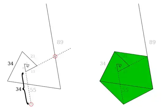

17
FibonacciPentagon1 FibonacciPentagon2 $$\phantom{xxxxxxxxxxxxxxxx}$$ FibonacciPentagon3
mr_e_man
  • 5,986
    +1. This was the visualization I'd considered posting. Now I don't have to! :) – Blue Jul 05 '24 at 06:01
    +1. If only we could also show how/why the pentagons don't come out quite right :-) – Jyrki Lahtonen Jul 05 '24 at 06:06
    @JyrkiLahtonen: "If only we could also show how/why the pentagons don't come out quite right" One way to do that would be to show angle measures (at least for the later iterations), indicating that they aren't $72^\circ$ but that they keep getting closer to it. – Blue Jul 05 '24 at 07:15
  • A lovely proof without words. Well, proof of concept at any rate – No Name Jul 05 '24 at 08:36

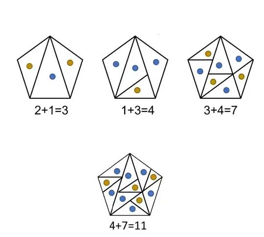

The dissection of a regular pentagon into triangles leads to a correlation with the Lucas numbers.
The division process shown below is described in detail at this MO post (Image by this author).
Subdivision of a regular pentagon into two groups of congruent triangles
We begin by dividing the pentagon into three triangles by drawing a pair of diagonals. Then the largest triangle is subdivided by setting off 36° from one of its 72° angles. In the next stage the largest triangles which now are the ones having 108° apex angles are subdivided by setting off 36° from that angle. This process is repeated, dividing the largest triangles each time. At each stage we have two groups of congruent isosceles triangles. The first group has 108° apex angles and their count is always an even-argument Lucas number ($L_0=2, L_2=3$, etc). The second group has apex angles of 36° and their count is an odd-argument Lucas number ($L_1=1, L_3=4$, etc). With infinitely many iterations the generated nodes form the tenfold quasilattice.
To get Fibonacci numbers count pieces within just one of the three triangles into which the pentagon is first divided.

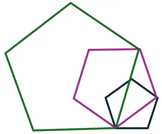

One (somewhat artifical) relationship (albeit not limited to a single pentagon) can be seen as coming from the key property of the golden ratio that $$ \phi^2 = \phi+1 $$ Consequently, $$ \phi^n = \phi^{n-1} + \phi^{n-2} $$ (Notice the Fibonacci-like pattern here!) It is easy to show that, by reducing this, we get $$ \phi^n = F_n \phi + F_{n-1} $$ for $F_n$ the $n$th Fibonacci number.
Draw a regular pentagon $P_1$ of unit side length. It has a diagonal of length $D_1 = \phi$.
Draw another regular pentagon $P_2$, with said diagonal as one of its sides. Then $$D_2 = \phi^2 = 1 + \phi$$
Repeat: draw a third regular pentagon, $P_3$, from that diagonal, using it as one of its sides. Then $P_3$ has diagonal $$ D_3 = (\phi+1)\phi = \phi^2 + \phi = 1 + 2\phi $$
The pattern continues on and on: we can easily establish that, however you wish to frame it, $$ D_n = D_{n-1} + D_{n-2} = \phi D_{n-1} = F_{n-1} + F_n \phi $$
This construction should naturally follow for the other metallic ratios as well.
A clunky visual of what the stacked pentagons would look like, green being $P_3$:
PrincessEev
  • 50,606
    Is there a nice way to see geometrically that the side length of the green pentagon is the sum of the side lengths of the black and purple pentagons? I can kinda see it if I squint but it'd be nice if there was a way to draw the diagram that made it really obvious. – Qiaochu Yuan Jul 03 '24 at 04:17
    @QiaochuYuan You can somewhat deduce it by considering the three equivalent isoceles triangles in the bottom right. – Zuy Jul 03 '24 at 06:30
    "This construction should naturally follow for the other metallic ratios as well." But not in general with polygons. You can use octagons for the silver ratio $1+\sqrt2$, but that's it for polygonal constructions unless you inelegantly use superpositions of different diaginal lengths. – Oscar Lanzi Jul 20 '24 at 10:00

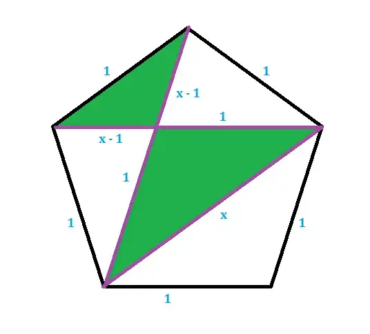

Consider this Diagram :
PENTAGON PHI
Sides are $1$ , Diagonals are $x$.
Diagonals are Parallel to Sides.
The Shaded triangles are "Similar" , hence we have :
$1/(x-1)=x/1$
Hence $1=x(x-1)$
Eventually we get :
$$x^2-x-1=0$$ $$x^2=x+1$$
Hence we have the Golden Ratio Relation here.
We can thus justify renaming $x$ to $\phi$ here.

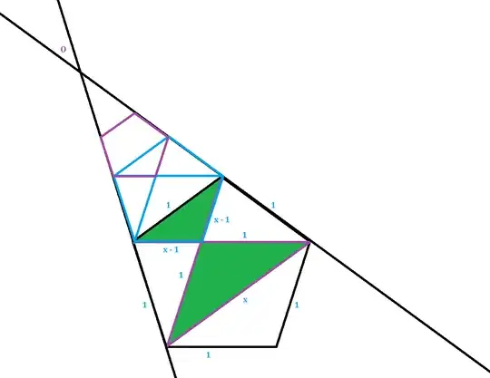

UPDATE :
We might want a "Series of Pentagons" where the ratio is either a Constant or will converge to the Constant.
Series of Pentagons
Smaller the Pentagon , Closer it gets to $O$.
Extending in the other Direction , we make larger Pentagons , going towards $\infty$.
Deriving the Constant here might give Alternate Ways to look at the Issue.

  • I know what you mean ,@QiaochuYuan , though my thinking is something like this : [[1]] Say we make a triangle with two Consecutive Sides , then calculate the largest internal angle ($108$) & then calculate the Diagonal (Side of the triangle) to get $2\sin(54)$ which will involve $\sqrt{5}$ , then we might ask : Where is the FIB Series ? We have used trigonometry to hide that relation which is then not easy to see. [[2]] What I have shown here is that we actually get the FIB Series relation via 2 "Similar" triangles. That will more easily highlight where / why the FIB Series is involved here. – Prem Jul 03 '24 at 05:20
    Some of the side-lengths of the blue pentagon in the bottom image might be illuminating. Namely, "base" has side length x-1, as do a few others. And, (x-1)+1 is x – Yakk Jul 04 '24 at 14:34
  • This is Correct , @Yakk , while the ratio $Side::Diagonal$ is always Constant. Extending the Pentagons either towards $O$ or towards $\infty$ will involve FIB Series : Sum (Difference) of a term with a term having $x$ factor. – Prem Jul 04 '24 at 15:01
    Here's what you may want to do. Let the first pentagon have side $s$ and the second have side $d$ (from the diagonal of the first pentagon). Show that subsequent pentagons have sides $s+d$, then $s+2d$, $2s+3d$, etc, generating the Fibonacci numbers as coefficients of the initial side and diagonal. – Oscar Lanzi Jul 09 '24 at 23:43
    A similar construction using regular octagons, and choosing the unique set of diagonals parallel to the sides, generates Pell number coefficients. – Oscar Lanzi Jul 09 '24 at 23:45
  • (1) Correct. That alternative way is nice too , @OscarLanzi , like what Yakk commented. (2) While your Suggestion will generate linear combination of $s$ & $d$ , my way & what Yakk gave will generate linear combination of $1$ & $x$ , Sum towards $\infty$ , Difference towards $O$ – Prem Jul 10 '24 at 04:06

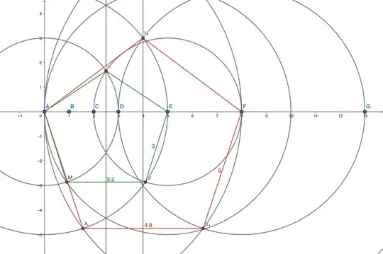

The figure shows two not regular pentagons constructed from the Fibonacci sequence $A,B,C,D,E,F$, taking consecutive Fibonacci numbers as side and diagonal. The two pentagons have a side with different length from the others. The sequence of pentagons shows how they tend to become a regular pentagon.
