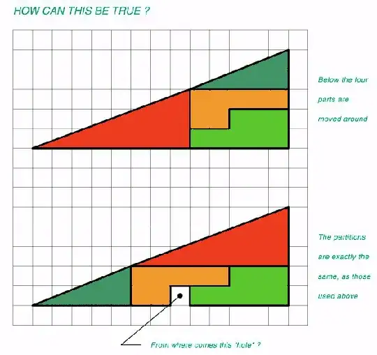

Below is a visual proof (!) that $32.5 = 31.5$. How could that be?
alt text
(As noted in a comment and answer, this is known as the "Missing Square" puzzle.)

Overlay the two triangles to see the difference. This is known as the missing square puzzle.

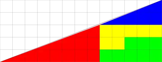

The area of the red triangle is $\frac12(8)(3) = 12$ and that of the blue triangle is $\frac12(5)(2) = 5$. The area of the yellow and green regions are clearly 7 and 8 respectively, so the total coloured area is 12 + 5 + 7 + 8 = 32 which is less than 32.5, the area of a 13×5 triangle. Indeed, in the figure below you can see that the hypotenuses of the red and blue triangles "dip" below the actual hypotenuse of the large triangle; this accounts for the 0.5 difference in area.
The first image

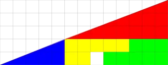

Similarly, in the second figure, the hypotenuse of the red and blue triangles are above the actual hypotenuse, which accounts for the 0.5 difference in area again.
The second image

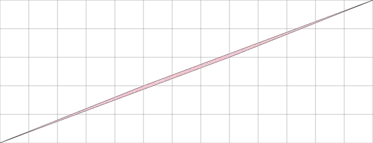

The difference between the two figures is a thin parallelogram with vertices at the endpoints of the hypotenuses in both figures (coloured pink below), which has area exactly 1. (If it looks much less, that's the nature of the optical illusion.)
The difference
