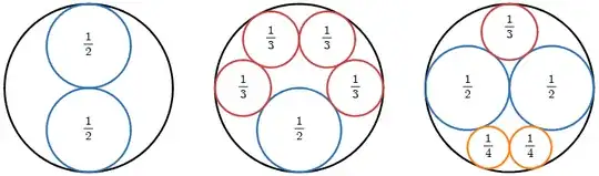

I know that $n$ can equal $2,3,4$:

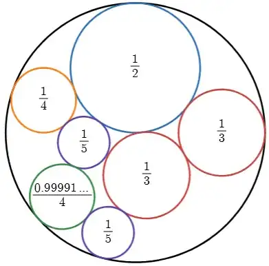

For $n=5$, the "closest" I have gotten is the following (here is the desmos graph).

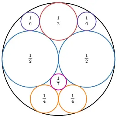

Below is a perfect fit with $\frac12,\frac13,\frac14,\frac16,\frac17$. (Missing $\frac15$, so no good.)
