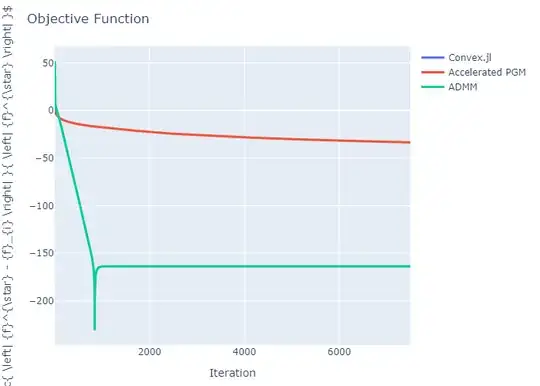

The problem is formulated as:
$$ \begin{align*} \arg \min_{\boldsymbol{x}} \quad & \frac{1}{2} \boldsymbol{x}^{T} \boldsymbol{K} \boldsymbol{x} - \boldsymbol{x}^{T} \boldsymbol{y} + \varepsilon {\left\| \boldsymbol{x} \right\|}_{1} \\ \text{subject to} \quad & \begin{aligned} \left| {x}_{i} \right| & \leq \frac{1}{2 \lambda n} \end{aligned} \end{align*} $$
It can be solved both as Proximal Gradient Descent and ADMM.
Since the constraint is basically a box constraint it can be incorporated into iterative proximal operator (See Lasso ADMM with Positive Constraint).
So the problem can be solved with the atoms of:
  • $ f \left( \boldsymbol{x} \right) = \frac{1}{2} \boldsymbol{x}^{T} \boldsymbol{K} \boldsymbol{x} - \boldsymbol{x}^{T} \boldsymbol{y} \Rightarrow \nabla f \left( \boldsymbol{x} \right) = \boldsymbol{K} \boldsymbol{x} - \boldsymbol{y} $.
  • $ \operatorname{Prox}_{\varepsilon g} \left( \boldsymbol{z} \right) = \max \left\{ \min \left\{ \mathcal{S}_{\varepsilon} \left( z \right), \frac{1}{2 \lambda n} \right\}, -\frac{1}{2 \lambda n} \right\} $ where $\mathcal{S}_{\varepsilon} \left( \cdot \right)$ is the Soft Threshold Operator which its output is box constrained.
The code implements Accelerated Proximal Gradient Descent (FISTA style).
It is able to solve the case of $n = 500$ in ~0.1 [Second].
ADMM
Defining the proximal of $f$ and using the same proximal for $g$:
  • $ f \left( \boldsymbol{x} \right) = \frac{1}{2} \boldsymbol{x}^{T} \boldsymbol{K} \boldsymbol{x} - \boldsymbol{x}^{T} \boldsymbol{y} \Rightarrow \operatorname{Prox}_{\rho f} \left( \boldsymbol{z} \right) = \arg \min_{\boldsymbol{x}} \frac{\rho}{2} {\left\| \boldsymbol{x} - \boldsymbol{z} \right\|}_{2}^{2} + f \left( \boldsymbol{x} \right) = {\left( \boldsymbol{K} + \rho \boldsymbol{I} \right)}^{-1} \left( \boldsymbol{y} + \rho \boldsymbol{z} \right) $.
The code pre factorize ${\left( \boldsymbol{K} + \rho \boldsymbol{I} \right)}^{-1}$ using Cholesky Decomposition.
It is roughly 3 times slower per iteration.
Yet it converges much faster, hence effectively almost an order of magnitude faster.
The full code is available on my StackExchange Mathematics GitHub Repository (Look at the Mathematics\Q4929444 folder).
