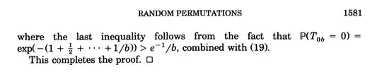

I think I've only found something like this result in this paper by Arratia and Tavaré:
https://projecteuclid.org/journals/annals-of-probability/volume-20/issue-3/The-Cycle-Structure-of-Random-Permutations/10.1214/aop/1176989707.full
on the cyclic nature of random permutations... but I am not versed enough in its notation to understand it very well, other than simply recognising it must be describing the same underlying pattern. (The 'result' appears as comment at the end of the proof at the top of page 1581.)
