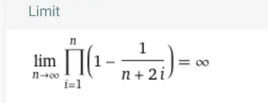

I don't see how to explain WolframAlpha's behavior. Mathematica returns the correct result using the input Limit[Product[1 - 1/(n + 2*i), {i, 1, n}], n -> Infinity], but WolframAlpha gives $\infty$ for the same.
