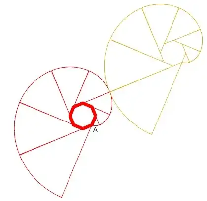

The fact that your curves are given in polar coordinates is less important than the fact that you need curves having a good representation in terms of curvilinear abscissa.
There are very few of them, set apart circles (the trivial case you have mentionned) and "Involutes of a Circle" (IC in short ; disclaimer : non standard abbreviation).
Precisely, these curves are used in the profile of gears : see the animation here displaying two opposite ICs rolling without slipping one on the other (see as well the graphical representation below).
Now, if you separate them by a distance $2R$, you can introduce a disk (circular galley) with radius $R$ between them : this disk will communicate the desired rolling-without-slipping movement from one IC to the other while staying in-place.
Fig. 1 : see explanation below.
One can have a good picture of an IC as a limit curve (like for a circle which is the limit of inscribed regular polygons). Consider the "spiral-looking" red curve in fig. 1 ; imagine a tethered goat in point A of an octogonal pillar discovering that its rope has in fact been rolled around the pillar ; the goat, by progressively unrolling the rope will be able to graze more and more land ; The frontier curve is an approximate IC ; replace now the octogon by any n-gon with $n \to \infty$ (always inscribed in the same circle) : you have now a correct idea of what an IC is.
Now, if we place a second similar IC in the position represented on fig. 1, the two ICs can roll one on the other because the addition of the resp. distances to their centers is a constant.
I haven't made a figure representing the circle that can be placed between the two ICs but it is not difficult to imagine it.
See many inspiring animations on this site.
