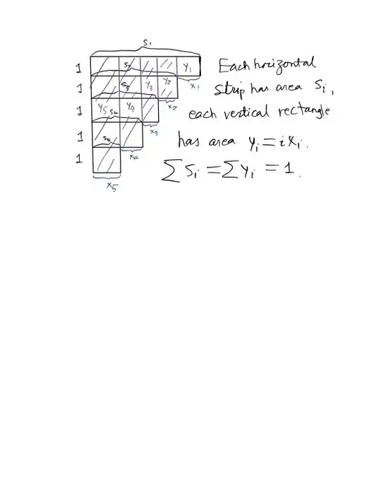

This feels a bit like the conjugate partition picture (see for example conjugate partition definition), and it involves counting in the horizontal and vertical directions.
In your situation, you are doing nonnegative real numbers $$ s_1\geq s_2\geq \dots\geq s_{n+1}\geq 0 $$ such that $\sum_{i=1}^{n+1} s_i = 1$. You can represent these numbers as areas of stripes with width 1 and length $s_i$. Then the total area of the shape is 1.
Now compute the area column first. Then you partition the shape into $n+1$ rectangles, where the $i$-th one (from the right) would have width $i$ and length $x_i$, since $x_i=s_i-s_{i+1}$. Its area is $$ ix_i=y_i,\quad\text{and }\sum_{i=1}^{n+1} y_i=1. $$
Now it remains to say that to randomly partition an area of 1 into $n+1$ horizontal stripes is to randomly partition it into $n+1$ vertical rectangles.
So this helps explain what the $y_i$ are, and we have $E[y_i]=\frac{1}{n+1}$.
Here is a drawing of what I mean, which is drastically not up to scales: the $s_i$ are smaller than 1. enter image description here

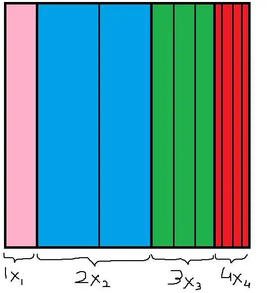

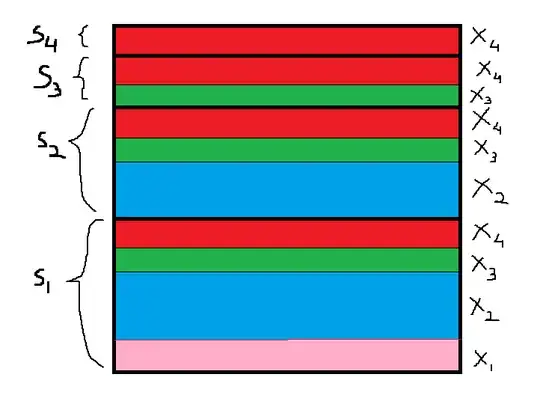

Carrying the above idea's geometric intuition (for the case $n=3$):
Figure1
The different colours represent different $x_i$, and the $s_i$ are separated by darker lines. Call this figure 1.
Now, consider a rearrangement (figure 2):
Figure2
Note that the $ix_i$'s are separated by three (or $n$ for the general case) dark lines. Once you insert these 3 dark lines, you can easily insert the lighter lines (in exactly one way), i.e, the $ix_i$s are uniquely determined by the $n$ dark lines. Since these three lines can be randomly put anywhere inside the square, and are independent, the expected value of $ix_i$ is $1/4 = 1/(n+1)$.
More directly, there is a clear bijection between the representation of any configuration $(s_1;s_2;s_3;s_4)$ (or $(s_1;s_2;\ldots;s_{n+1})$ in the general case) between figure 1 and figure 2.
So instead of going from constructing figure 1, and converting to figure 2, we do the reverse:
  1. In a square, randomly draw $3$ (or $n$) vertical lines.
  2. Call the $4$ regions so formed $y_1,y_2,y_3,y_4$ (or $y_1,y_2,\ldots y_{n+1}$).
  3. Divide $y_i$ into $i$ equal parts, such that $x_i = y_i/i$ is the length of one part of $y_i$.
  4. Now, there are $i$ copies of $x_i$. Rearrange them into groups such that $(x_1,x_2,x_3,x_4;x_2,x_3,x_4;x_3,x_4;x_4) := (s_1;s_2;s_3;s_4)$.
Note that the division of $y_i$ into subparts of length $x_i$ in Step $3$ takes place after Step 1. So, step 3 does not affect the expected value of $y_i$ in step 1. By a reasonable assumption of an uniform distribution and using symmetry, $\Bbb E[y_i] = 1/4$ (or $1/(n+1)$ in the general case).
