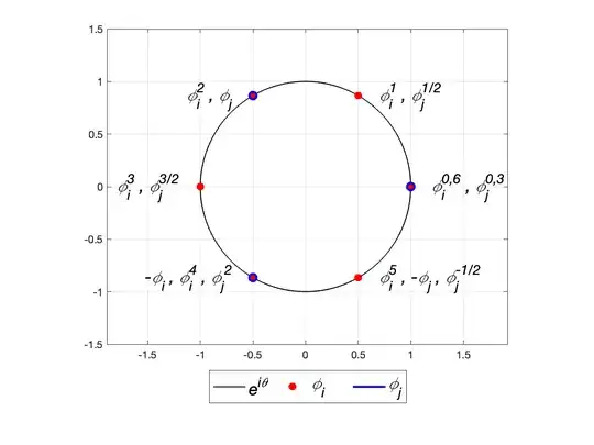

These relations and several others can become apparent when looking at $\sqrt[3]{1}$ and $\sqrt[6]{1}$ on the unit circle, as shown in the figure below.
I am seeking external validation for this analysis.
unit circle with 3 and 6 roots

  • When you say you're searching for external validation, external validation of the correctness of the overall analysis? I do believe the properties you've found are correct, interesting in an artistic mathematics sense, and mirror the properties of the golden ratio and imaginary golden ratio. – MathTrain Feb 06 '24 at 00:57
    @cye-waldman I checked your last graph because I was playing with similar sequences . You are showing how the roots of unity make $\varphi_i$ a 6-gon generator and $\varphi_j$ a 3-gon generator. As all n-gons can be thought as a composition of triangles I feel that $\varphi_j$ is the coolest one, because it generates the others. Note 0,8,3,11,6,1,9,4,12,7,2,10,5 in A257961 and how this one emerges when coloring the vertex of growing-radius and periodically shifted 13-gons ($\varphi$-gons) when using $\varphi =F_N/F_{N-1}=f_s/f=T/T_s$ in $$r_{n} e^{\frac{2\pi i}{\varphi}n}$$ . – fbatrouni Jun 22 '24 at 07:24
