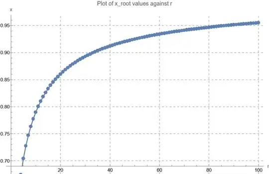

Here's the plot of numerical solution: enter image description here Any help or guidance would be greatly appreciated.
  • Like mentioned in the other discussion you linked, you can find analytical solutions for r = 0,1,2,3,4, or numerical approximation. Generally, such equations are difficult to solve – Nicola Zaugg Feb 04 '24 at 15:34
  • You accept that there isn't a simple closed form solution, and you have the numerical solution in your post, so what are you're actually asking for? – Sal Feb 04 '24 at 15:35
  • Is it hard for you to solve the equation because of the extra $(4+2r)$ factor? – Тyma Gaidash Feb 04 '24 at 15:39
  • yes, that's exactly my problem @ТymaGaidash – Amirhossein Rezaei Feb 04 '24 at 15:41
  • I'm sorry but there was a mistake in the equation, I fixed it (the exponent is $r+1$ and not $r$). @ТymaGaidash – Amirhossein Rezaei Feb 04 '24 at 16:29
    Interesting problem since it is the inverse of $$r+2=\frac 1 {\log(x)},W_{-1}\left(\frac{1}{2} x (x+1) \log (x)\right)$$ – Claude Leibovici Feb 06 '24 at 10:35
  • I actually found this when I was working on a problem about finding the ground state of a particular interaction matrix of a fully connected Ising Hamiltonian. Very interesting stuff. @ClaudeLeibovici – Amirhossein Rezaei Feb 06 '24 at 19:17
  • Much improved. I think that we could also get the exact solution – Claude Leibovici Feb 13 '24 at 05:02
  • when $r$ is even there is only one real $x$. Although it seems it is out of range, when $r$ is odd you have a negative and a positive value for $x$. – ZKZ Aug 21 '24 at 23:49
