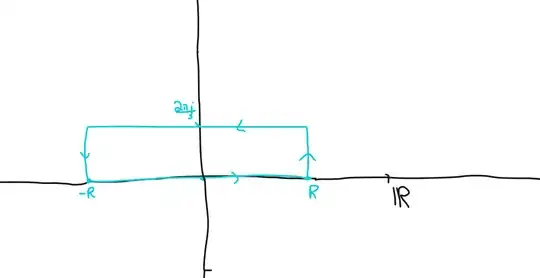

Alright, so the semicircular arc doesn't work. We can still do something; a nice trick is to exploit the periodicity of the exponential. If $x\mapsto x+\frac{2\pi i}{3}$, the integrand transforms like $f(x)\mapsto e^{2\pi i/3}f(x)$, thus: $$(1-e^{2\pi i/3})I=\oint_{\text{Large boxes of height $2\pi/3$}}=2\pi i\cdot\mathrm{Res}\left(f;\frac{\pi i}{3}\right)$$Where now, truly, the 'error' terms - the short integrals of type $\int_R^{R+2\pi i/3}$ and $\int_{-R}^{-R+2\pi i/3}$ - really do vanish by an easy check. The integral coming back down the final edge of the box, $R+2\pi i/3\to -R+2\pi i/3$, is just a multiple of $I$ by my observation.
There is only one pole enclosed in my contour, which is also nice. The residue computation is as you say, so we find: $$I=\frac{2\pi i}{1-e^{2\pi i/3}}\cdot\frac{1}{3e^{2\pi i/3}}=\frac{\pi}{3}\csc(\pi/3)=\frac{2\pi}{3\sqrt{3}}$$Here's an image:
And we take limits in $R\to\infty$.

  • Hi FShrike, I know that there are other contours to use, I just don't know how to use them because finding the integrals along the other contours is tricky for me, while I thought that the integral along the semicircular arc is always zero. Also, can you provide a picture of the contour "Large boxes of height $\frac{2\pi}3$"? i.e. the space between them, whether they are rectangles, how the real number line is involved, etc. – Kamal Saleh Jan 19 '24 at 18:48
    @KamalSaleh I've included an image of the contour. The 'error' integrals are not always zero, so my message to you is to always check it - at least, sketch a proof of how to check it. – FShrike Jan 19 '24 at 19:04
