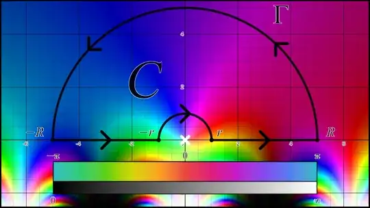

Let $\displaystyle f(z) = \frac{\exp\left(e^{iz}\right)}{z}$. There is a simple pole at $z=0$ because the principal part of the Laurent expansion of $f(z)$ is $\displaystyle \frac{e}{z}$. We can take the OP's idea and construct this contour.
(I forgot to label the small circular arc $\gamma$.) By Cauchy's Integral Theorem, we write $\displaystyle \oint_C f(z)dz$ as
$$ 0 = \int_{-R}^{-r}f(z)dz + \int_{\gamma}f(z)dz + \int_r^R f(z)dz + \int_{\Gamma}f(z)dz\,. $$

We solve the integral over $\gamma$ like this.
$$ \lim_{r\to0^+} \Im \int_{\gamma} \frac{\exp\left(e^{iz}\right)}{z}dz = -\Im i \pi\mathop{\mathrm{Res}}_{z=0} \frac{\exp\left(e^{iz}\right)}{z} = -\pi \Re \lim_{z\to0}(z-0)\cdot\frac{\exp\left(e^{iz}\right)}{z} = -\pi e \,. $$
To solve the other contour integral, we can first rewrite it as
$$ \begin{align} \Im \int_{\Gamma} \frac{\exp\left(e^{iz}\right)}{z}dz &= \Im \int_{\Gamma} \frac{1}{z} \sum_{n=0}^{\infty} \frac{e^{niz}}{n!}dz \\ &= \Im \sum_{n=0}^{\infty}\frac{1}{n!}\int_{\Gamma}^{ }\frac{e^{niz}}{z}dz \tag{1}\\ &= \Im \sum_{n=0}^{\infty}\frac{1}{n!}\int_{0}^{\pi}\frac{\exp\left(niRe^{it}\right)}{Re^{it}}iRe^{it}dt \\ &= \Re \sum_{n=0}^{\infty}\frac{1}{n!}\int_{0}^{\pi}\exp\left(niRe^{it}\right)dt \\ &= \Re \frac{1}{0!}\int_{0}^{\pi}\exp\left(0\cdot iRe^{it}\right)dt + \Re \sum_{n=1}^{\infty}\frac{1}{n!}\int_{0}^{\pi}\exp\left(niRe^{it}\right)dt \,. \\ \end{align} $$
For $(1)$, since $\exp(e^{iz})$ is entire, its radius of convergence is $\infty$. Note that $\Gamma$ is inside the circle of convergence of the infinite series, which justifies the $\sum$ and $\int$ swap.
The first integral from that last equality equals $\pi$. We bound the second integral like $$ \begin{align} 0 &\leq \left|\Re\sum_{n=1}^{\infty}\frac{1}{n!}\int_{0}^{\pi}\exp\left(niRe^{it}\right)dt\right| \\ &\leq \left|\sum_{n=1}^{\infty}\frac{1}{n!}\int_{0}^{\pi}\exp\left(niRe^{it}\right)dt\right| \\ &\leq \sum_{n=1}^{\infty}\frac{1}{n!}\left|\int_{0}^{\pi}\exp\left(niRe^{it}\right)dt\right| \\ &\leq \sum_{n=1}^{\infty}\frac{1}{n!}\int_{0}^{\pi}\left|\exp\left(niRe^{it}\right)\right|dt \\ &= \sum_{n=1}^{\infty}\frac{1}{n!}\int_{0}^{\pi}e^{-Rn\sin t}dt \\ &< \sum_{n=1}^{\infty}\frac{1}{n!} \cdot \frac{\pi}{Rn}\,. \tag{2} \\ \end{align} $$
For $(2)$, we use Jordan's Inequality to find an upper bound tight enough for that integral.
We take $R \to \infty$ and use the Squeeze Theorem to show that the second integral converges to $0$. We eventually conclude that
$$ \lim_{R\to\infty}\Im \int_{\Gamma} f(z)dz = \pi\,. $$
Finally, $$ \begin{align} 0 &= I - \frac{1}{2}\pi e + \frac{1}{2}\pi \\ \implies I &= \frac{\pi}{2} (e-1) \\ \end{align} $$
