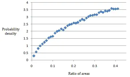

The probability density function of the ratio looks roughly like this:
