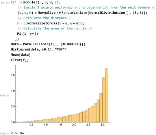

Below is a simulation of $10^7$ trials using Mathematica 13, demonstrating a sample mean that is quite close to the exact value above:
Simulation

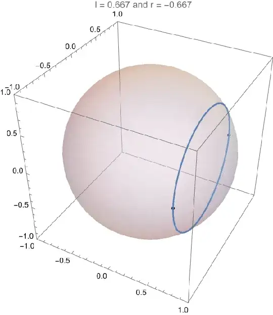

Step 2. Now we condition on the event $\{L = l\}$. In doing so, we may assume that the line $\overline{AB}$ lies in the $xy$-plane, passes through the point $(l, 0, 0)$, and is perpendicular to the $x$-axis. In other words, we may assume that
$$ A = (l, \sqrt{1-l^2}, 0) \qquad\text{and}\qquad B = (l, -\sqrt{1-l^2}, 0). $$
Now, given the value of $l$, we introduce the following parametrization of $\mathbb{S}^2$:
$$ \Psi_l(r, \theta) = r \left(\sin\alpha, 0, \cos\alpha\right) + \sqrt{1-r^2} \bigl[ (\cos\alpha, 0, -\sin\alpha) \cos\theta + (0, 1, 0) \sin\theta \bigr] $$
Here, $-l \leq r \leq l$ and $-\pi \leq \theta \leq \pi$, and $\alpha = \arcsin(r/l)$. This parametrization is designed so that the following property holds:
Property. For each fixed $r$, the curve $\theta \mapsto \Psi_l(r, \theta)$ is a circle that passes through the points $A$ and $B$, and the plane containing this circle is at a distance of $|r|$ from the origin.
Below is an animated example of this circle where $l = 2/3$ and $r$ varies from $-l$ to $l$:
Animated example
