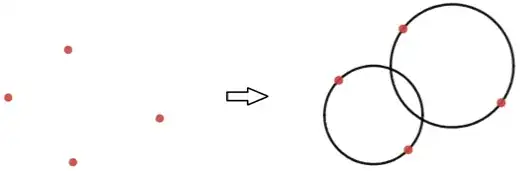

Show that, given four coplanar points, we can always draw two intersecting circles coplanar with the points, such that two of the given points are diameter endpoints of one circle, and the other two given points are diameter endpoints of the other circle.
In this question, "intersecting" means that the circles share at least one common point.
Example:
I will post my answer. Alternative solutions are welcome.
