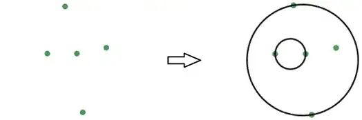

Example:
Example 1

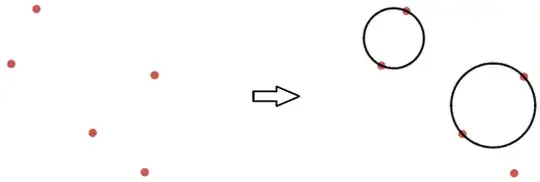

Another example:
Example 2

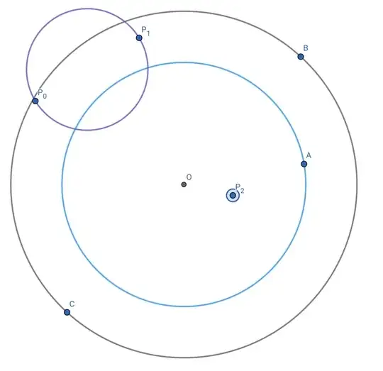

Consider the two points such that the distance between them is maximum, In the diagram, I call those two points $C$ and $B$, we will work in the complex plane with the origin as $O$, the midpoint of $CB$.
There is a special blue circle inside my diagram, centered at $O$ is such that if it had a radius of $1$, then circle $BC$ will have a radius of $\sqrt2$. (Scale accordingly)
This blue circle has the property of if any two points lie within this circle, then the circle formed by these two points necessarily do not intersect with circle $CB$. Proof: Consider any two points inside or on the unit circle call $x,y$ Then the point on the circle formed by $xy$ furthest away from the origin has magnitude: (1) $|(x+y)/2+i(x-y)/2|$ where i is the imaginary unit. Then bound using triangle inequality:
$(1)\le(0.5)(|x||1+i|+|y||1-i|)\le 0.5(2\sqrt2)=\sqrt2$
With this, we see that it is necessary that at most 1 point can lie within the blue circle.

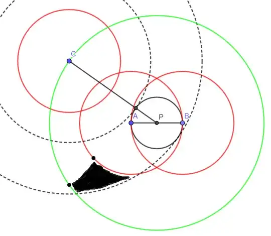

Denote the five points as $A,B,C,D,E$. Suppose no three of them are collinear, otherwise the conclusion holds immediately.
First we pick $A,B$ such that they have the minimum distance. Let $P$ be the midpoint of $AB$.
Among $C,D,E$ assume $C$ is the farthest one to $P$. Then we can draw some circles.
In the following figure, the red circles means $D,E$ must be outside them, since $AB$ is the shortest, the green circles means $D,E$ must be inside it, since $C$ is the one farthest from $P$, and the annulus with dashed lines means that $D$ must be inside it if we want the circle with diameter $CD$ intersects with the one with diamter $AB$.
Now we can suppose both $D,E$ are in the annulus. We can observe that only two small regions are left for them. In fact, the actual regions such that circle($CD$ or $CE$) and circle($AB$) intersects is much smaller, and one of them is approximately drawn in black.
If $D,E$ are in the same regions (e.g. both in the black region) then circle($DE$) do not intersect with circle $AB$. If $D,E$ are in different regions then circle($DE$) will cover circle($AB$).
