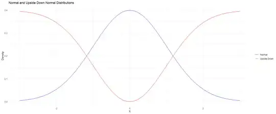

Using computer programming languages (e.g. R), I know this is possible. For example:
library(ggplot2)
x <- seq(-3, 3, by = 0.01) y <- dnorm(x) y_upside_down <- max(y) - y
df <- data.frame(x = c(x, x), y = c(y, y_upside_down), curve = rep(c("Normal", "Upside Down"), each = length(x)))
ggplot(df, aes(x = x, y = y, color = curve)) + geom_line() + scale_color_manual(values = c("Normal" = "blue", "Upside Down" = "red")) + theme_minimal() + labs(x = "X", y = "Density", title = "Normal and Upside Down Normal Distributions") + theme(legend.title = element_blank())
But now I am wondering, what would the corresponding function look like for the red curve?

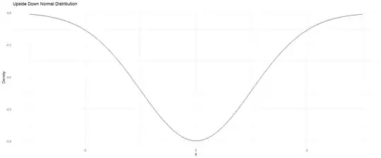

Idea 1: The first thing that came to mind was just to take the negative of a normal distribution :
$$-f(x) = \frac{1}{\sqrt{2\pi}} e^{-\frac{(x-\mu)^2}{2}}$$
But this will have negative densities, and this is not possible (i.e. not a valid probability distribution):
y_upside_down <- -y
ggplot(data.frame(x = x, y = y_upside_down), aes(x = x, y = y_upside_down)) + geom_line() + theme_minimal() + labs(x = "X", y = "Density", title = "Upside Down Normal Distribution")
Idea 2: The other idea I had was to take this negative function and shift it vertically by the maximum point - but likely also won't result in a valid probability distribution (i.e. will not integrate to 1):
$$f_{\text{mirrored}}(x) = f_{\text{max}} - f(x)$$
Can someone please show me how to do this correctly? Is there an exact probability distribution that corresponds to the upside down normal distribution? Or is there some method I can use to transform the regular normal distribution into the distribution I am looking for?

    If $f$ is a nonnegative function satisfying $\lim_{x\to\infty}f(x)>0$ then it can't satisfy $\int_{-\infty}^\infty f(x)dx=1$. Think about the area under the curve. – Karl Nov 22 '23 at 03:38
  • A probability distribution $f$ must satisfy $\lim_{x\to\pm\infty} f(x)=0$. But it also satisfies $f(x) \ge 0$. So it must go down as you follow it off to infinity. – MJD Nov 22 '23 at 03:39
    @MJD No, it doesn't have to satisfy $\lim_{x \to \pm \infty} f(x) = 0$. Think of a sum of tall, thin "bumps", But it certainly can't have $\lim_{x \to \pm \infty} f(x) = c$ for some $c \ne 0$. – Robert Israel Nov 22 '23 at 04:17
  • @RobertIsrael right! Thank you for pointing out my mistake. – MJD Nov 22 '23 at 06:09
An upside down bell-curve can never give you a valid probability distribution function. This is because for any valid pdf $f_X(x)$, we must satisfy the condition $\displaystyle \int_{-\infty}^\infty f_X(x)dx = 1$. Note that this means that the integral of the pdf over the real line is finite. This could happen when:
  1. The negative part of the function cancels out with part of the positive part of the function, eg. with the function $\operatorname{sinc} x$. In this case it is not possible, as a valid pdf must always have $f_X(x) \geq 0$.
  2. The function is wholly positive and tends to $0$ as $x$ tends to $\infty$ or $-\infty$. In the case of the inverted bell curve, the function would constantly be increasing as $x$ tends to both $\infty$ or $-\infty$, tending towards some fixed positive value, $k$, without ever reaching it. Thus the value $\displaystyle \int_{-\infty}^\infty f_X(x)dx $ MUST diverge.
