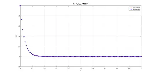

I made a graph to check my approximation. It seems correct as shown below. I call the function without the infinite sum a closed from function. The graph is constructed for $k=30$ and $n_{max} = 100001$. I used $100$ points for the $x$ axis.
Graph

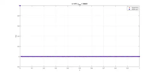

which I also checking using the graph given below, where $k$ was changed to $677$:
Plot

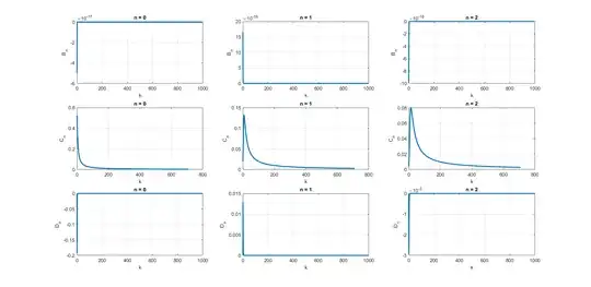

I thought I made a mistake somewhere in my calculations of $B_n$, $C_n$ and $D_n$ as $k$ tends to infinity. However, I tried plotting $B_n$, $C_n$ and $D_n$ with respect to $k$ for $n = \{0, 1, 2 \}$. It really does seem that they tend to zero as $k$ gets bigger as shown in the graphs below:
matrix
However, that seems to me like a contradiction to the fact that $f(0) = 1$. So my question is, where did I go wrong here? How can I prove that the inifinite sum defined by $(4)$ is equal to $1$ and did I really calculate the limits correctly or not?
