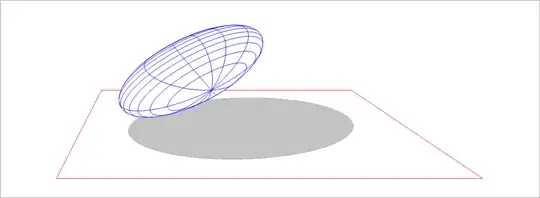

An ellipsoid with equation
$ (\mathbf{r} - \mathbf{r_0} )^T Q (\mathbf{r} - \mathbf{r_0} ) = 1 $
is subject to light rays from an omni-directional light (light source emitting light rays in all directions). The light source is located at $\mathbf{p_0}$.
I want to find a closed form expression for the area of the shadow of the ellipsoid onto the plane $\mathbf{n}^T (\mathbf{r} - \mathbf{r_1} ) = 0 $.
My attempt: is presented in my answer below.
