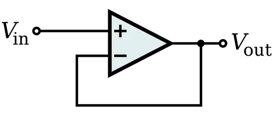

I came across this realisation while trying to understand a feedback loop of a buffer circuit of an op-amp. Op-amp Buffer
The relation every op-amp follows is $V_{out} = A (V_+ - V_-)$ where $A \rightarrow \infty$ and by setting the $V_{out}$ and $V_-$ to be equal, we get a scenario where $V_{in} \frac{A}{A+1} = V_{out}$ or $V_{in} \approx V_{out}$
Trying to visualize how this circuit would converge on this input, I tried seeing how to $V_{out}$ changes as a sequence.
Suppose initially $V_{in}$ is 0, then $V_{out 0} = 0$. Now if $V_{in} = \delta V$, then $V_{out1} = A (V_{in} - V_{out0}) = A\delta V$
In the next step of the sequence, $V_{out2} = A (V_{in} - V_{out1}) = (A-A^2)\delta V$
In general, $$V_{outn} = A (V_{in} - V_{out(n-1)}) = \delta V (A - A^2 + A^3 - .... + (-1)^n A^n)$$
We know that this should converge to $\delta V \frac{A}{A+1}$.
Henceforth, this divergent behaviour somehow converges to finite value.
I was hoping to understand this behaviour better, can anyone guide me on this?

The actual recurrence relation you're seeking in this analysis is: $$s(n)=V_{n+1}=\lim_{A\rightarrow\infty}A(V_n-V_{n-1})$$ (You can shift the subindices how you like, just leave the actual sequence number $s(n)$ untouched). Set the first input $V_{in}=V_1=k$, with $V_0=0$, where $k\in\mathbb{R}$ is any real value (idk if complex-valued voltages are a thing) to get: $$s(1)=\lim_{A\rightarrow\infty}A(k-0)=\infty$$ $$s(2)=\lim_{A\rightarrow\infty}A(\infty-k)=\infty$$ $$s(3)=\lim_{A\rightarrow\infty}A(\infty-\infty)$$ $$\vdots$$ You can easily see that for $n\geq3$ the sequence $s(n)$ is undefined. Also, we can algebraically check that: $$\begin{array}&\small s(1)=\lim_{A\rightarrow\infty}&kA\\\small s(2)=\lim_{A\rightarrow\infty}&k(A^2-A)\\\small s(3)=\lim_{A\rightarrow\infty}&k(A^3-2A^2)\\&\vdots\end{array}$$ This suggests that the sequence has a more complicated form than that of a simple geometric series, so i doubt that the sequence has the nice closed form you described as its limit. As for the question, divergent series never converge, but algebraic manipulations can make the sum have a limiting value. You can check an example here.
    The coefficients in the recurrence in that case match: https://oeis.org/A115139 – Sidharth Ghoshal Oct 28 '23 at 00:22
  • The thing is that $V_{in}$ is fixed and is independent of the sequence. So this recurrence relation is for something else. – Boy Oct 28 '23 at 03:12
  • Then $s(n)=V_{n+1}=\lim_{A\rightarrow\infty}k-V_n$ should work as well ($k$ is the fixed voltage). Do note that the initial voltage $V_{in}$ cannot be zero, otherwise, the whole sequence collapses equally to zero. – Simón Flavio Ibañez Oct 28 '23 at 04:24
