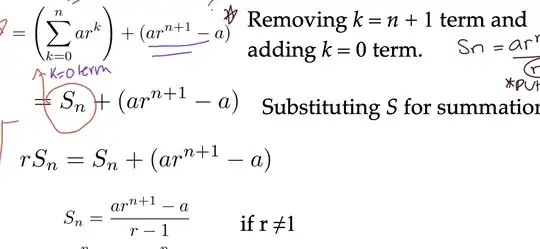

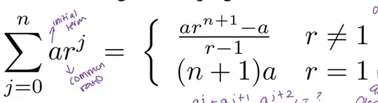

So for, the above formula, how did they get $(n+1)$ a for the geometric progression when $r = 1$. I also am confused where the negative a comes from in the following sequence of steps.

  • If $r=1$, then you have $n+1$ time $a+a+a+\cdots +a$. This implies $\sum=a(n+1)$. – lone student Sep 20 '21 at 17:28
  • There are $n+1$ terms in $\sum_{k=0}^n.$ – Thomas Andrews Sep 20 '21 at 17:29
  • The second question is unclear, because you didn’t give us the left hand side of the equality. We can guess, but … – Thomas Andrews Sep 20 '21 at 17:30
8
When $r=1$ we have
$$S_{n}=\sum_{j=0}^{n}ar^{j}=\sum_{j=0}^{n}a=\underbrace{a+a+a+...+a+a}_{(n+1)-\text{times}}=...$$
For $r\neq 1$, let
$$S_{n}=\sum_{k=0}^{n}ar^{k}=a+ar+ar^{2}+...+ar^{n-1}+ar^{n}$$
Multiplying by $r$ we have
$$rS_{n}=\sum_{k=0}^{n}ar^{k+1}=ar+ar^{2}+ar^{3}+...+ar^{n}+ar^{n+1}$$
Then which terms cancel when we compute $rS_{n}-S_{n}$?
Or adding and subtracting the term $a$ to the RHS of $rS_{n}$ we have
$$rS_{n}=\color{red}{a}+ar+ar^{2}+ar^{3}+...+ar^{n}+ar^{n+1}-\color{red}{a}$$ $$=\left(a+ar+ar^2+...+ar^{n}\right)+ar^{n+1}-a$$
and what is the term in the brackets equal to?
