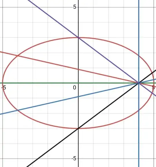

I want to divide an ellipse into $n$ equal parts with vertex at one of the foci.
I chose $n=12$ and drew six lines in the ellipse:
  • A line that goes through points $(0,b)$ & $(f,0)$: $y=-\frac{b}{f}x+b$, and the opposite line $y=\frac{b}{f}x-b$.
  • A line that goes through $(f,0)$ & $(-f,\frac{b^2}{a})$: $y=-\frac{b^2}{2af}x+\frac{b^2}{2a}$, and the opposite line $y=\frac{b^2}{2af}x-\frac{b^2}{2a}$.
  • And the lines $x=f$, & $y=0$.
I plugged $a=5$, $b=3$, and $f=4$; and the result using Desmos graphing calculator:
Ellipse
Clearly the elliptical segments don't have equal areas (each two segments have equal areas); per Hagen's comment that's because I have lines that create opposite segments.
What should the lines be so that all areas are the same? Can we obtain an answer regarding $n$ parts in general or we have to choose a number for $n$ like I did? Of course I need parametrical equations like what I wrote in the question body, not numerical like $y=2x+3$.
I also tried integration but it's very complicated.
Note: This question has nothing to do with Kepler's second law. Please approach it in a geometrical and algebraic sense.
    To begin with, you cannot expect all segments to align with their "opposite" segments – Hagen von Eitzen Oct 14 '23 at 10:05
  • So maybe it's better to go backwards. I mean first construction of an ellipse with equal-area segments, then finding the coordinates of points of intersection between the lines and the ellipse, to finally have the equations of all twelve lines. –  Oct 14 '23 at 11:04
  • This may be useful: https://math.stackexchange.com/a/4778185/255730 – Intelligenti pauca Oct 14 '23 at 15:27
  • If you want to avoid angles then you must compute nasty integrals. And even with angles what you ask requires solving (numerically) a non-algebraic equation. – Intelligenti pauca Oct 15 '23 at 09:46
  • @Intelligentipauca Oh, I see now. –  Oct 15 '23 at 09:49
  • See also this one: https://math.stackexchange.com/questions/388134/how-to-calculate-ellipse-sector-area-from-a-focus/1007302#1007302 – Intelligenti pauca Oct 15 '23 at 09:50

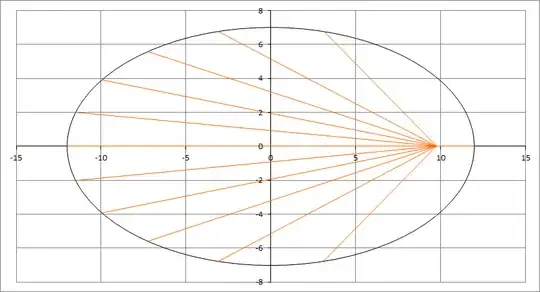

Here's the solution.
The parametric equation of the ellipse is
$ r(t) = (a \cos t , b \sin t ) $
Now you just need to compute $t_0, t_1, t_2, \dots , t_{12} $ such that
$ A = \dfrac{1}{2} \displaystyle \bigg| \int_{t_{k-1}}^{t_k} r(t) \times r'(t) \ dt \bigg| = \dfrac{\pi}{12} $
With $t_0 = 0 $
The lines connect the focus located at $(\sqrt{a^2 - b^2}, 0) $ to $ (a \cos t_k, b \sin t_k ) $
Here's the program to generate this segmentation.
Public Sub segmenting_an_ellipse_into_12_equal_area_segments()
Dim t(12) As Double
Dim pts(10, 2) As Double
Dim r0(2), v(2, 2) As Double
a = 12
b = 7
r0(1) = 0 r0(2) = 0
v(1, 1) = a v(2, 1) = 0
v(1, 2) = 0 v(2, 2) = b
c = Sqr(a ^ 2 - b ^ 2)
sx = 1 / a
sy = 1 / b
cx = c * sx
'find the t's
t(0) = 0
For k = 1 To 12
' equation is 1/2 integral ( t(k-1) TO t(k) ) ( (cos t - cx , sin t ) X (-sin t, cos t ) ) = 1/6 . pi/2
' so, integral ( t(k-1) TO t(k) ) ( (cos t - cx , sin t ) X (-sin t, cos t ) ) = pi / 6
' This simplifies to integral ( t(k-1) TO t(k) ) [ 1 - cx cos t ] dt
' = [ t(k) - t(k-1) ] - cx [ sin(t(k)) - sin(t(k-1) ] = pi / 6
' and further into
' t(k) - cx sin(t(k)) + ( - t(k-1) + cx sin(t(k-1)) - pi/6 ) = 0
Call find_tk(k, t, cx)
Next k
k = 1 narcs = 0
ipass = 2
Call draw_ellipse(r0, v, 1)
For k1 = 0 To 12
x1 = c y1 = 0
x2 = a * Cos(t(k1)) y2 = b * Sin(t(k1))
Call draw_line_segment(0, x1, y1, x2, y2, 46)
Next k1
Call plot_curve(0, 1, 0, 0, 0, "", "")
End Sub Public Sub find_tk(k, t, cx)
c0 = -t(k - 1) + cx * Sin(t(k - 1)) - p / 6
' x - cx sin(x) + c0 = 0
' derivative, 1 - cx cos(x)
x = k / 6 * p
For ic = 1 To 50
y = x - cx * Sin(x) + c0
yp = 1 - cx * Cos(x)
dx = -y / yp
If Abs(y) < 0.00000001 Or Abs(dx) < 0.00000001 Then
t(k) = x Exit Sub
End If
x = x + dx
Next ic
MsgBox ("Newton did not converge")
End Sub
  • Thank you very much. Can we obtain the answer if we use the general equation of ellipse? –  Oct 15 '23 at 13:48
  • Certainly. The location of the center of the ellipse, and its rotation with respect to axes does not change the values of $t_0, t_1, \dots , t_{12} $. All you need to change is to replace the coordinates of the focus, and the semi-major and semi-minor vectors. –  Oct 15 '23 at 13:50
    Shouldn't the right side in the integration be $\frac{\pi*ab}{12}$? –  Oct 15 '23 at 13:54
  • I tried the general equation, but I failed. I created a segment in the ellipse with vertex at the right focus. I called the intersection of line from the focus to ellipse $$(m, \frac{b}{a}\sqrt{a^2-m^2})$$ Then I calculated the area between the line and $y$ axis (a triangle + the integral from $m$ to $a$). Then I equaled it to $\frac{ab\pi}{12}$. After several simplifications I reached $$3\cos(\theta)\sqrt{a^2-b^2}+3a\theta=a\pi$$ which I'm unable to continue. ($m=a\sin(\theta)$) –  Oct 15 '23 at 14:03
  • Hmmm. I don't know exactly what you're doing. –  Oct 15 '23 at 14:44
  • About the right hand side. You're right. Corrected the solution. –  Oct 15 '23 at 15:58
