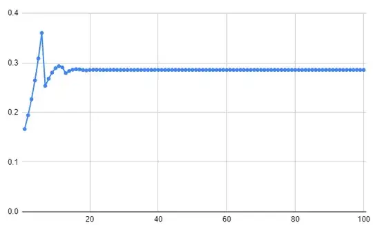

A graph for $n=6$
It converges quickly to $P_{\infty}=\frac{2}{n+1}$

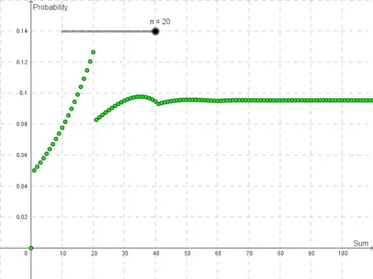

Based on the answer to this question, the formula I want for the discrete case is
$$ \sum_{k = 1}^{S} \left(\sum_{i = 0}^{\lfloor \frac{S - k}{n} \rfloor} \left((-1)^i × \binom{k}{i} × \binom{S - n × i - 1}{k - 1}\right) × \left(\frac{1}{n}\right)^k\right) $$
Plot of discrete points

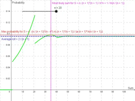

The continuous case is a little more complicated. It consists of a piecewise-defined function where the segment $P_j(S)$ is defined as
$$ P_j(S) = \sum_{m = 0}^{j} \left(\frac{S × (n + 1)^{S - m × n - m - 1}}{(S - m × n) × n^{S - m × n}} × \frac{Γ(m + m × n - S)}{Γ(m + 1) × Γ(m × n - S)}\right), \\ j × n + 1 ≤ S < (j + 1) × n + 1, \\ j ∈ \mathbb{N}^0 $$
Plot of piecewise function
The sum with the greatest probability of being rolled is $S = n$, with probability $P = \frac{(n + 1)^{n - 1}}{n^n}$. If you restrict $S$ to values greater than $n$, the sum with the greatest probability of being rolled is to $S = \frac{(n + 1)^{n - 1}}{n^n} + \frac{1}{\ln\left(\frac{n}{n + 1}\right)}$, with probability $P = \frac{-\left(\frac{n}{n + 1}\right)^{n - n^{-n} × (n + 1)^{n + 1}}}{e × (n + 1)^2 × \ln\left(\frac{n}{n + 1}\right)}$.
