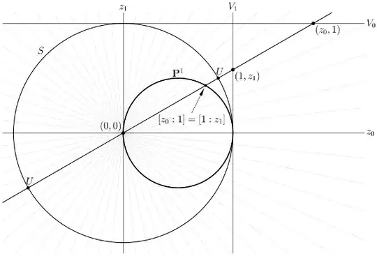

First, a sketch of the real points, from here:
The real points of the complex projective line depicted as a circle of radius one-half in the real plane, passing through the origin and tangent to the vertical axis
