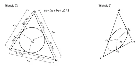

Thanks to user Blue for pointing out the term "inellipse"—from this pointer I've arrived at a workable formula. To help explain the derivation, here are example diagrams of Triangles $T_0$ and $T$. The value $s_0$ is defined as the half-perimeter of triangle $T_0$.
In triangle $T_0$, the lengths of the sides have been labeled and, additionally, the lengths of the segments of the triangle sides formed by splitting each side at the touch-point of the incircle have been labeled. These segment lengths can be derived using Heron's formula and the law of cosines (see the wikipedia page on Heron's formula for a derivation).
Let $\vec{P_a}$, $\vec{P_b}$, and $\vec{P_c}$ be the transformed positions of the three incircle touch-points in triangle $T_0$ (on sides $a_0$, $b_0$, and $c_0$, respectively) to triangle $T$. Because the transformation implied by $\mathbf{M}$ is a linear transformation, the ratio of the two segments on either side of each touch-point must be equal to the ratio of the segments on either side of the transformed touch-points in triangle $T$. So we have:
