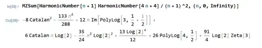

For OP's sum, one simply input enter image description here the program only accepts sum from $0$ to $\infty$, so we need to do a shift by $1$. This corroborates OP's result.

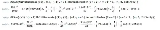

What OP called "skew-harmonic number" $\overline{H}_n = \sum_{i=1}^n \frac{(-1)^{i-1}}{i}$ is represented in the program as MultiHarmonic[{1},{1},{-1},n], the two sums OP mentioned can also be computed using same algorithm:

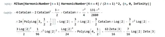

OP asks about the sum $\sum_{n=1}^{\infty}\frac{H_n H_{4n}}{(2n-1)^2}$ at the end, it equals enter image description here note that the weight is now inhomogeneous.
