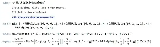

Such sums can be evaluated pretty much systematically via MZV, giving $$\DeclareMathOperator{Li}{Li} \color{royalblue}{8 \pi \Im\left(\text{Li}_3\left(\frac{1}{2}+\frac{i}{2}\right)\right)+24 \text{Li}_4\left(\frac{1}{2}\right)+\frac{7}{4} \zeta (3) \log (2)-\frac{149 \pi ^4}{720}+\log ^4(2)-\frac{5}{4} \pi ^2 \log ^2(2)} \approx 2.35042$$

A Mathematica package introduced here automatically performs these steps:
