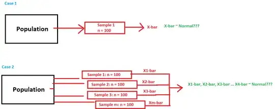

- Even though I interviewed 100 students - effectively, I only have a single sample
  • As I understand, the Central Limit Theorem states that the mean of a (large enough) sequence of samples will be Normally Distributed - Thus, is it correct to use the Central Limit Theorem in this question to construct a Confidence Interval for the average height of the entire population?
In this problem, I understand that I can easily calculate the Standard Deviation of the sample itself - that is, how much does the height of any given student in the sample deviate on average from the average height of all students in the sample.
But in this problem, is it really correct to use the Central Limit Theorem to calculate the Confidence Interval of the average height - when all I have is a single sample?
I think the Central Limit Theorem would be more applicable if many people each took a single sample of size 100 - and then calculated the average height of students in the sample they took. Then, you would have a sequence of sample means - and in this case, the Central Limit Theorem could be used to calculate the Confidence Interval of the sample mean.
Is my reasoning correct?

Note: I have attempted to illustrate both situations - in Case 1, I think the Central Limit Theorem does not apply. In Case 2, I think the Central Limit Theorem does apply:

As others have pointed out in the comments, the CLT is perfectly acceptable for a single sample -- the CLT isn't about "samples of samples" or anything like that.
In the classic version, it says that the distribution of the sample mean of $n$ iid random variables, each with mean $\mu$ and standard deviation $\sigma$ approaches that of a normal distribution as the sample sizes get bigger.

Most statistical studies are exemplified by Case 1 in your post -- we normally don't artificially split our sample into smaller iid subsamples (unless we are stratifying etc) because we'd get a better estimate using all the data to estimate the mean.
However, if you did do Case 2, you would see that the distribution of the sample means of, say, 1000 (centered and scaled by the mean and standard deviation of the underlying population, respectively) and multiplied by $\sqrt{n}$ would be very close to a standard normal distribution.

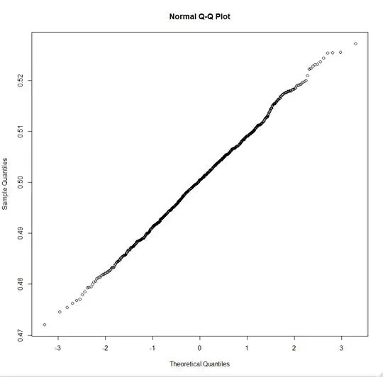

You can show this to yourself by running this small snippet of R code:
avgs <- c()
for(i in 1:1000){
  avgs <- append(avgs,mean(runif(1000)))
qqnorm(avgs)
You'll see that the sample averages for $n=1000$ is are very normally distributed: enter image description here

  • @stats_noob I agree that its not obvious you can do this -- that is also why the CLT is such an amazing theorem and basically drove the development of classical statistical inference (and it still does!). You are correct that each sample will give you a different sample mean -- what the CLT allows us to assume is that the sample means are normally distributed around the TRUE mean -- in particular $\sqrt{n}\left(\frac{\bar X - \mu}{\sigma}\right)$ has a $N(0,1)$ distribution.
    This is an amazing result because of its specificity and generality.
    –  Jul 31 '23 at 16:54
