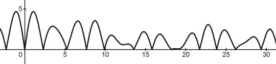

For example, here is the graph of $f_{2^{1/j},\color{red}{5}}(x)$ :

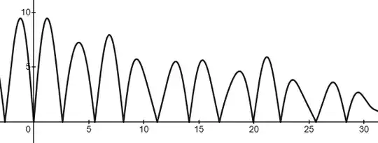

And here is the graph of $f_{2^{1/j},\color{red}{10}}(x)$ :

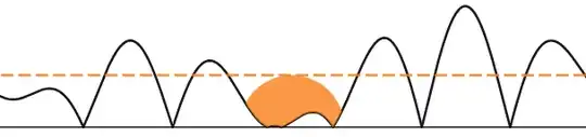

Visual representation of the mean value:
If my conjecture is true, then there is a nice way to visually represent the mean value of the function. Draw a circle of area $n$ with its centre on the $x$-axis. A horizontal line through the top of the circle represents, approximately, the average value of the function.
