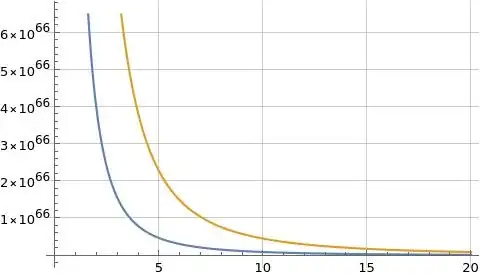

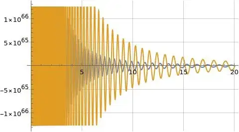

I don't believe the inverse Mellin transform of $i^{-s}$ converges, but one can approximate the inverse Mellin transform of $i^{-s}$ as
$$f(x)=\mathcal{M}_s^{-1}\left[i^{-s}\right](x)=\underset{T\to\infty}{\text{lim}}\left(\frac{1}{2 \pi i}\int\limits_{c-i T}^{c+i T} i^{-s}\, x^{-s} \, ds\right)$$ $$=\underset{T\to \infty }{\text{lim}}\left(\frac{e^{-\frac{1}{2} \pi (T+i c)} \left(e^{\pi T}-x^{2 i T}\right) x^{-c-i T}}{\pi (\pi -2 i \log (x))}\right)\tag{1}.$$
Figures (1) to (3) below illustrate $|f(x)|$, $\Re(f(x))$, and $\Im(f(x))$ where formula (1) is evaluated with $T=100$ and $T=101$ in blue and orange respectively where in all cases the value $c=2$ was used to evaluate formula (1). I believe $c=2$ is a valid choice since the function $i^{-s}$ is analytic for $s\in\mathbb{C}$. Note formula (1) for $f(x)$ seems to diverge significantly in magnitude as $T$ increases.
Figure (1): Illustration of $|f(x)|$ with $T=100$ (blue) and $T=101$ (orange)
Figure (2): Illustration of $\Re(f(x))$ with $T=100$ (blue) and $T=101$ (orange)

I'll also note the frequency of the oscillations in $\Re(f(x))$ and $\Im(f(x))$ also seem to diverge (increase) as $T$ increases, but this is perhaps not as noticeable in Figures (1) to (3) above. This is because $T=100$ and $T=101$ are very close in magnitude and the frequency oscillation doesn't seem to diverge as rapidly as the magnitude as $T$ increases.
