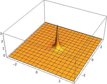

I then attempted to extend the limit representation of $\delta(x)$ defined in formula (1) above to the complex plane as follows:
$$\delta(s)=\underset{\epsilon\to 0}{\text{lim}}\left(\frac{\epsilon}{\pi\,\left(s\,s^*+\epsilon^2\right)}\right),\quad s\in\mathbb{C}\tag{2}$$
Figure (2) below illustrates $\delta (s)$ defined in formula (2) above evaluated for $s\in\mathbb{C}$ using $\epsilon=0.1$.
Illustration of formula (2)
Figure (2): Illustration of formula (2) for $\delta (s)$ evaluated over the complex plane using $\epsilon=0.1$
